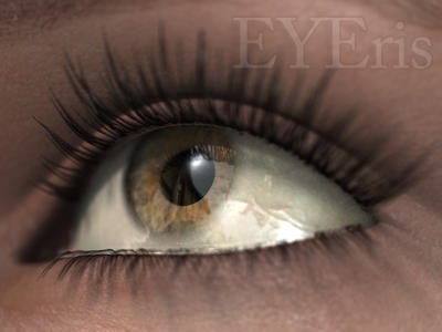

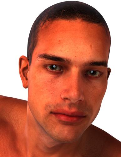

    I just did a render of M6 and I can confirm that M6/G2M and V6/G2F do indeed share eye UV's. Although the render contains only the G2F eye presets from Re-interjection, it does point the way for Project EYEris 2 to be used on M6/G2M, so you do wonder if you actually need there to be a set made for M6/G2M when the current ones will work. I suppose you could do an add on with different iris textures or something, it's up to you.
    I might get Project EYEris 2 this week and see how I get on
    CHEERS!

    I get what you're saying and I was referring purely to G2F and files made just for them. The render I posted is of M6 using the G2F eye preset from Re-interjection, nothing to do with Gen 4. My bad with the title of the pack, you're right on that one it is a Subsurface Expansion pack for the original. What is clear though is that we don't really need another expansion pack for G2M/M6 as my render has proved that they share eye UV's with G2F/V6 so you can use the relevant presets in the SS pack for either of them. The blurb for the expansion pack only refers to G2F, but, I'm guessing she was all that was out at the time that the pack was being developed.
    CHEERS!

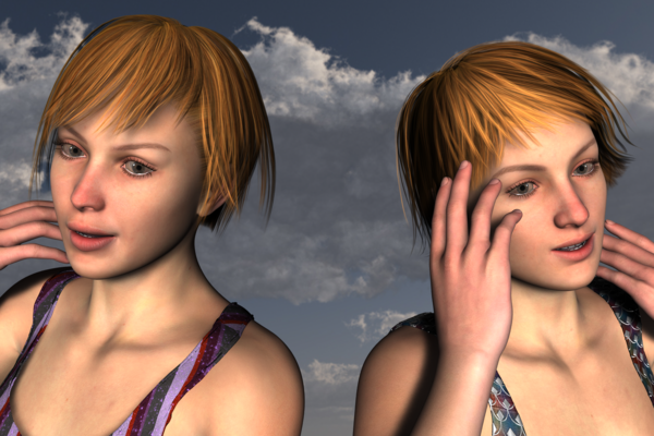

    Took me more than one day to test all the possible methods I could think of, but here is what I found to work consistently for getting the Project EYEris Subsurface Expansion properties onto Genesis 1:
    1. Load both Genesis 1 and 2 into your scene and select all the eye related surfaces of both figures at the same time and restore them to DS Default (just to be safe - may not be needed)
    2. Apply PES iris choice to Genesis 2
    3. Apply PES sclera choice to Genesis 2
    4. Apply PES eye surface choice to Genesis 2
    5. Apply DPTE tear choice to both Genesis 1 & 2 at once
    6. Apply DPTE lacrimal choice to both Genesis 1 & 2 at once
    7. Select Genesis 2's cornea, pupil, iris, and sclera surfaces and save as shader presets
    8. Apply those presets to their equivalent Genesis 1 surfaces
    9. Select Genesis 2's eye reflection surface and save as shader preset
    10. Apply the that preset to Genesis 1's eye surface prop
    11. Test render, adjust if needed, and enjoy!
    You will get something like this: (Genesis 1 on the left, Genesis 2 on the right, both V4 shaped and Bree textured for better comparison)
    Oh yeah, also, all the full eye presets are DPTE named, and I have found that anything with that prefix will load directly onto Genesis 1 or 2 with no problems or extra workarounds needed. It's only the PES named materials from the expansion that need these extra steps. The PES iris materials apply to the Iris, Pupil, and Cornea of Genesis 2 all at once but require 3 different shader presets to be saved in order to transfer to Genesis 1. Also, this trick works for getting anything to transfer between Genesis 1 and 2 surface-wise, so long as it is something they both have the same UV's for. Because both of my Genesis models have V4 uv's available to them I was able to make these eye shaders transfer. Getting things from Genesis 1 to 2 is easier than vice versa because you can save everything on Genesis 1 as a single material preset and apply it to Genesis 2 no problem, but going backwards requires each individual surface to be saved out as a shader preset instead .
