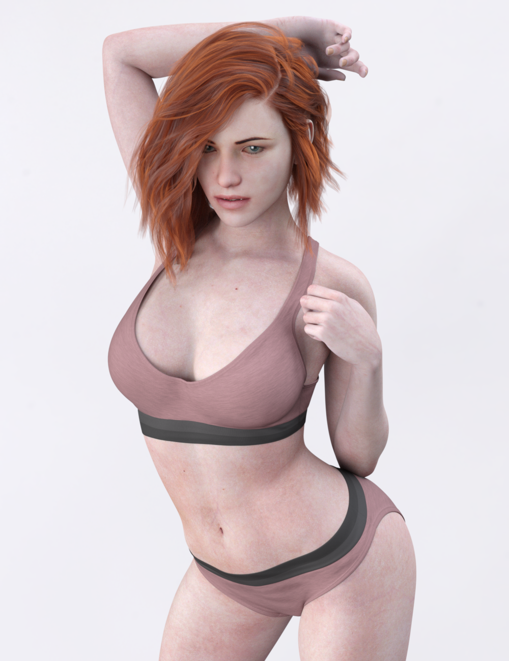

    Sure! Which scenes do you want to see? I should probably start a thread laugh
    For example this scene for my Pale Skin Shader Promo (No minor postwork version wink)
    All I have is:
    1. An Iray render HDRI map from DAZ Original Product called (Something)StudioA  that has been here for like, 2 years ago? laugh
      • Rotate the dome so that the white area in the HDRI is behind the character with
        • Enviroment intensity 1.00 (Untouched)
        • Enviroment Lighting Resolution 4096
        • Exposure Value 12.00
        • Shutter Speed (1x) 64.00
        • Spectral Rendering OFF
    2. A plane light primitive facing the front of the character with light set to:
      • Full White Emission Color
      • 6500.00 (default) Emission Temperature
      • 25 Luminance
      • cd/cm^2 Luminance Units
    And boom hit render yes
    1000 x 1300 - 1M
    Post edited by EcVh0 on

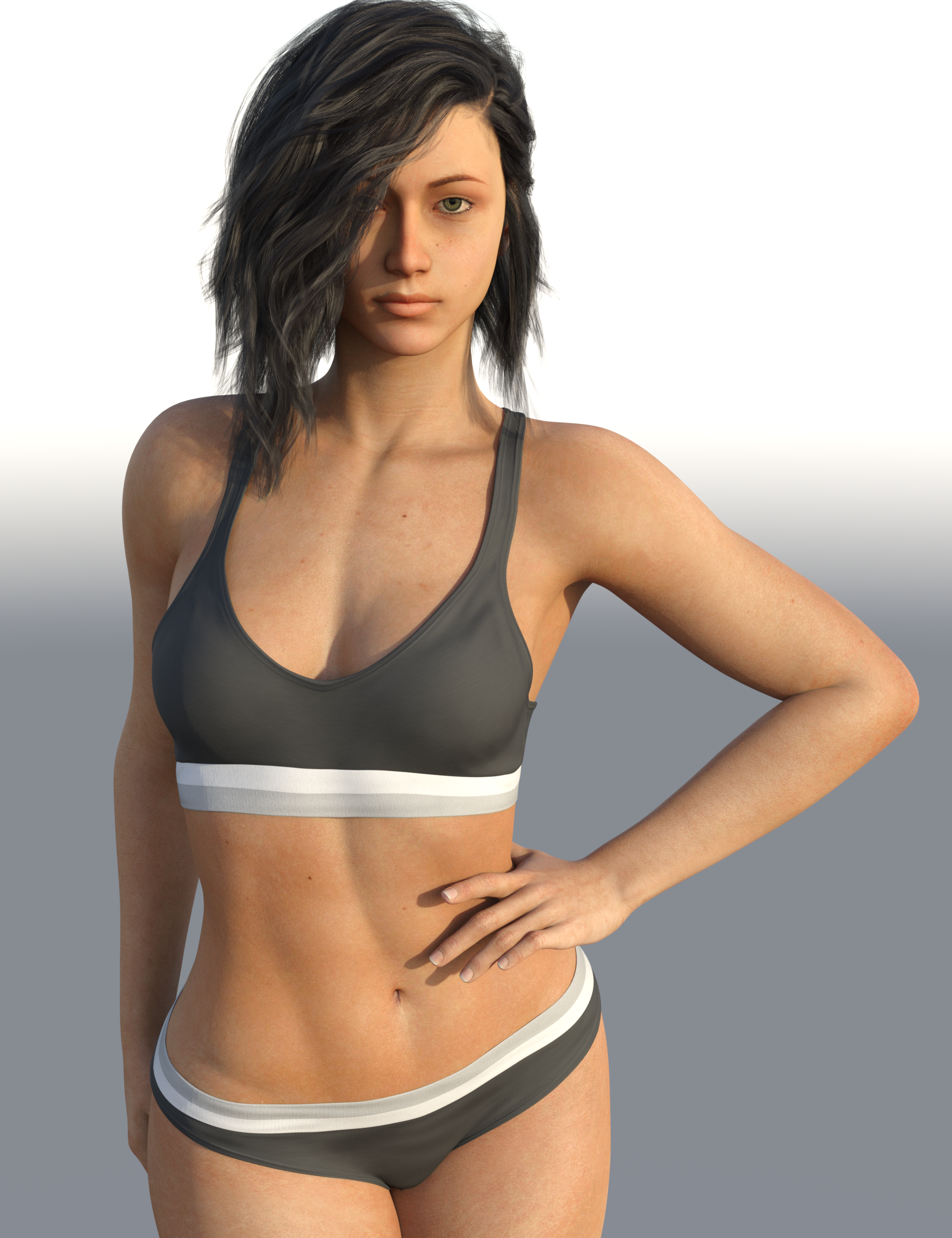

    Here's a render I did this morning with just sun-sky enviroment, no post work wink
    2000 x 2600 - 5M
