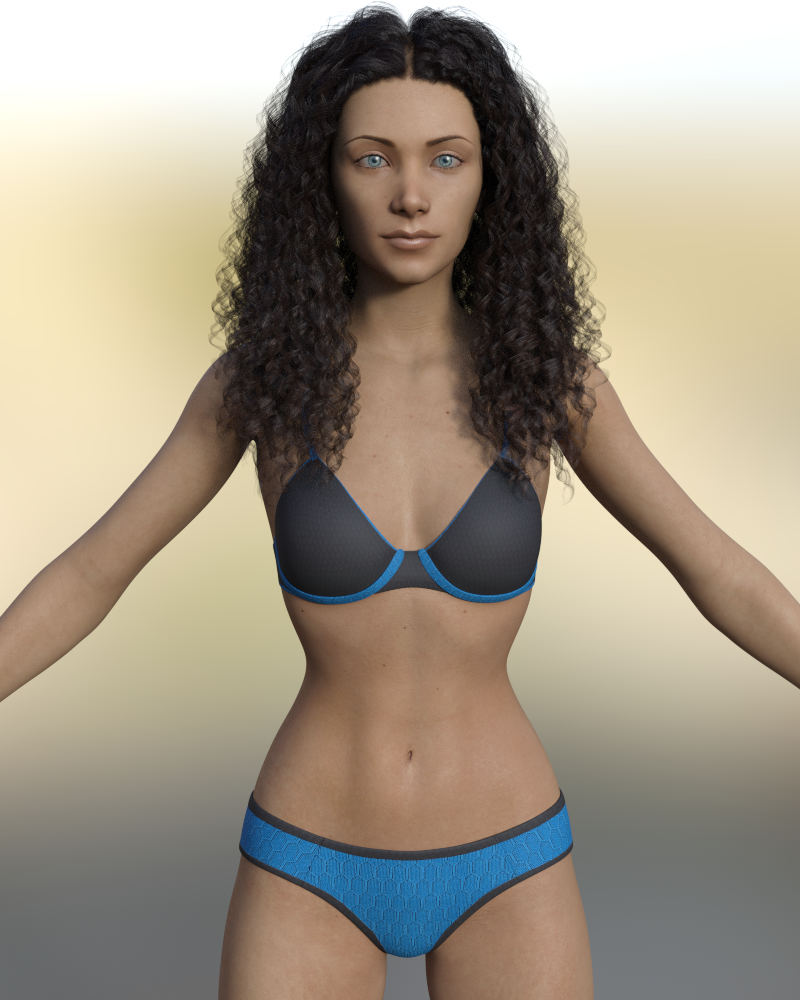

    Diva the morph works as a morph dial - I have zipped it up & attach it here in the correct format for the share
    Thanks for the morph :)
    zip
    zip
    DivaFreebies.zip
    214K
    800 x 1000 - 829K
    Post edited by Tottallou on
  • xmasrosexmasrose Posts: 1,410
    It works fine. Lovely morph thank you.

    Oh, thank you so much for packaging it for me! I really appreciate it! :D
    Now if I can only remember how I created the morph. lol I can't seem to replicate it. /doh! lol
