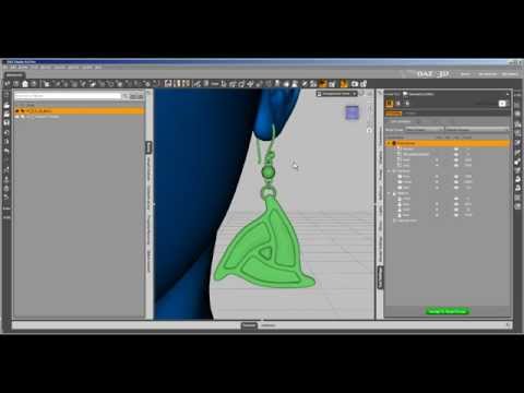

    this video on earring rigging in DS may help you. Similar concept.
