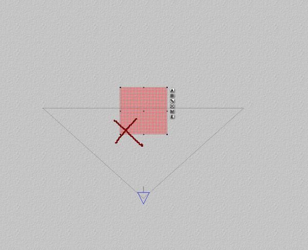

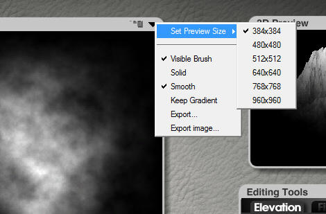

    My solution to this perpetual problem is not to rotate the terrains and to have the camera pointing what I call North.
    Image 1 shows a newly created terrain.
    Image 2 shows the terrain lab for this terrain.
    As things stand, in this scene, the bottom left hand corner of the terrain relates to the bottom left hand corner of the height map.
    Taking this approach I find reduces the confusion considerably.
    Edit: the images came in backwards for some reason, but if you mouseover the file names are shown.

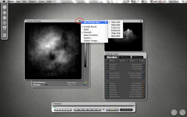

    Maybe another stupid question, but on the terrain editor, si there any way to increase the sixe it appears when using it? My extra keyboard keys don't work in Bryce, not even the zoom
  • David BrinnenDavid Brinnen Posts: 3,136
    Yes, I keep mine small for video, but otherwise it can fill the screen almost. Image shows where the little menu is "hidden".
    470 x 309 - 63K

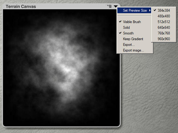

  • HoroHoro Posts: 11,674
    Do you mean that one?
    596 x 444 - 36K
