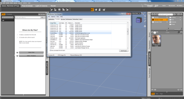

    ive been reading these pages for hours and nothing changed,i uninstalled all my daz studio content even the install manager!then re installed daz studio 4.6 x64 and yeah nothing changed.i checked my cms and its running but nothing is showing in the smart content.ill call it retarded content from now on -__- uhhh.can anyone please help me or tell me what the heck is wrong with daz or me? id really appreciate it.
    1920 x 1019 - 181K
    anytime you look at the left thing there, and see no categories under "ALL", it is a clear sign that CMS is not running.

    i uninstalled my windows,and installed all the programs again...also DAZ3D ofcourse.Downloaded daz install manager to start from scratch,installed it again and.....this time even the content manager doesnt show up on my processes...i can consider myself as a new Daz3d user but i've been using cg softwares since forever and never saw such a crappy buggy hard to get used yo software like Daz...The help documents and such are not even up to date for the latest version...And i cant understand how they change the user interface in major way from one version to the other...uhhhhhhhh...so it seems like the content manager is insisting on not working even if i activate it from its location in C:/daz folder nor from start menu.Giving my best regards to the developers <3</p>
    edit : after a few mintues this picture came up again .i guess im giving up -______-
    1920 x 1030 - 288K

    actually i figured out that it sometimes turns on sometimes doesnt.but no matter what,nothing changes in the smart content panel...and yeah it also shows up in the services.i decided to uninstall it and install again now its all corrupt.is there a way to remove daz and all of its system files from the computer?install manager leaves so much rubbish behind.im starting toget sick of it -_-
    edited May 2014
    I notice the RAM usage is rather high, akin to the levels I had when I was trying to run Daz Studio 4.6 on Windows XP 32bit with only 3GB of RAM.
    I'm not accusing, only pointing out, that Daz Studio need way more 'real ram' to work properly. What OS are you using, and how much 'Real Ram' is in the computer.
    The OS makes a difference as to where the CMS database is kept. It only takes deleting the five CMS database files, and restarting CMS, assuming nothing else in the computer is blocking CMS.
    (Screen-cap from XP)
    600 x 345 - 18K
