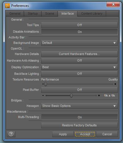

    DS 4.5 is slowing down for me massively after about 30 minutes of use. Applying poses that were instantaneous when I first start using the app suddenly become noticeably slower.
    Nothing else is running but Studio
    here are my interface settings
    specs i7-920 2.4GHz., 12GB RAM, GTS 250 1GB RAM, Drivers are up-to-date.
    430 x 499 - 44K
    Consistently after half an hour? No matter how much you've done?
    How much space is on your hard drive? Is it a large single drive or partitioned? Is DS on it's own partition? Is the DS temp file/data folder/etc on the same drive?
    What are your Windows settings...things like power saving/etc?
  • StratDragonStratDragon Posts: 3,290
    no, I'm adding things (props, I haven't done multiple gen4 figures yet) to my scene but same things in DS3 would not cause this sluggishness, it never did anyway.
    Studio is on it's own RAID 0 partition with the OS, approx 250 GB free
    runtime and temp are on an internal drive dedicated to DS with just over 20 GB free
    both drives a 0% fragmented btw, Seagate Barracuda 7200 RPM SATA direct internal to the mobo.
    no power saves, it's a dekstop, I've turned them all off, I've stripped out most of the services through management console that the system doesn't need, It's a rendering box, I don't game on it, I don't do much other than Blender and Studio and Adobe CS2 on it and some light surfing, but I don't even use email on it. I'm planning on whacking the raid and reinstalling the OS and again I'll run a dedicated drive to the runtime so the level 3 does not need to swap with the drive writing temp files.
    Other than the drive spinning down, I can't see any reason with that set up for it to even want to think about slowing down...and I don't see why the drive would want to spin down (it's not a 'green' drive, is it?),,,
