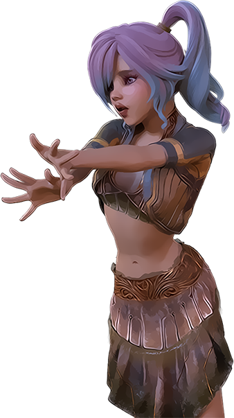

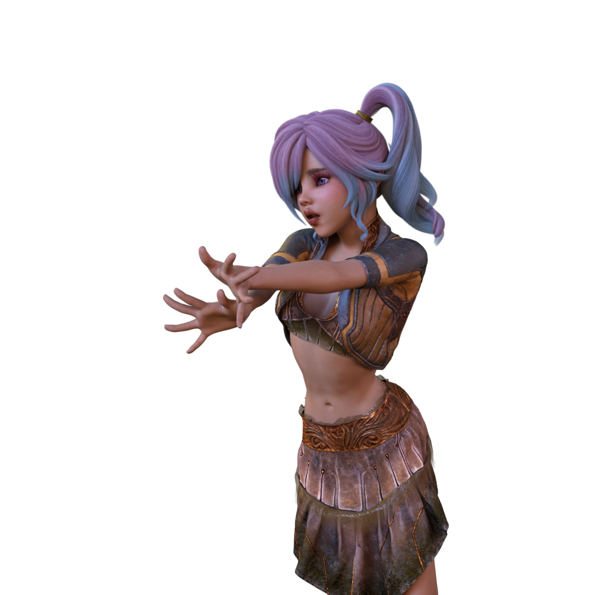

    Aeon Soul gives always the tip for pixel filter : (tip: remember to set your "Filtering > Pixel > Pixel Filter Radius" at 0.50 or so to enjoy all the crispy details of the textures, especially in very close-up renders). :)
  • exstarsisexstarsis Posts: 2,128
    edited June 2017
    I did some tests and I could see a difference but it's easiest when switching between the two pictures directly. And my tests were 'default' and 'mitchell .7' and 'mictchell .4'.  Also including the default and the .4 run through Topaz Clean, where the sharper filters produces better cartoon lines. Clickable links open in new windows so you can switch between tabs to compare instantly.Look at the skirt and fingertips in the Clean version; you can see details sharper in the hair (Charity Med-Rez) and skirt in straight renders.
    Default Filter:
    .4 Mitchell
    Topaz Clean Cartoon Default
    Topaz Clean Cartoon Mitchell .4
    1200 x 1200 - 635K
    1200 x 1200 - 731K
    338 x 603 - 216K
    337 x 604 - 240K
    Post edited by exstarsis on
