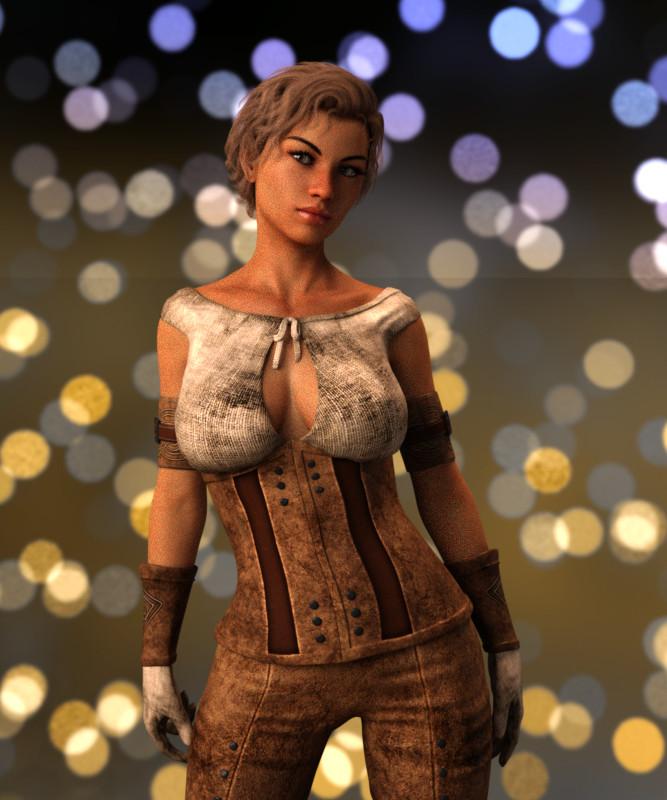

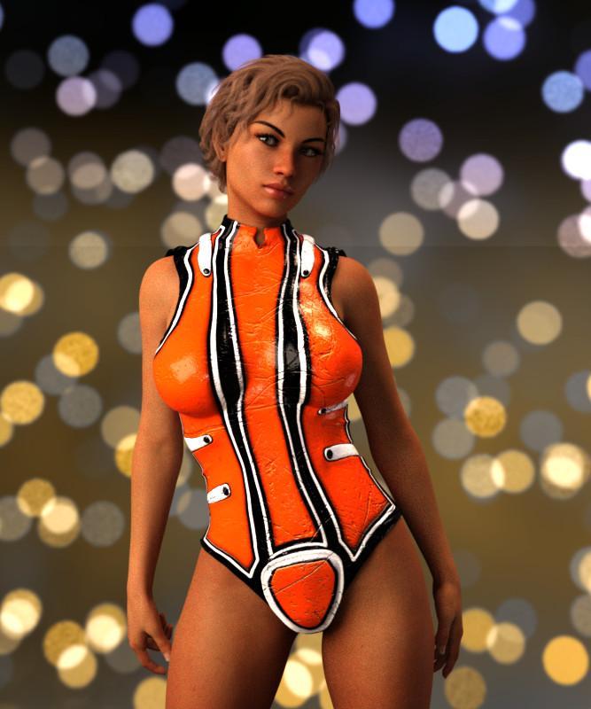

  • DustRiderDustRider Posts: 2,911
    edited June 2017
    Maybe I'm totally missing something here. My understanding is that your not able to auto-fit any clothing for G2F or Genesis to G8/V8? If so, then I'm definitely not having a similar issue. I'm able to auto-fit most G2F and Genesis clothing to G8/V8. there are a few things that don't work well at all, and some require adjusting the collision and/or smoothing parameters (or possibly adding a push modifier), but not really anything different than what I experienced with G3F. The options for auto-fit aren't as "rich" as they are with G3F (i.e. for most clothing items you need to select full body, no options for gloves, pants, etc) but auto fir works as expected for me. if you aren't getting any options, maybe you need to uninstall the G8F essentials and reinstall them?? If I'm way off base here on what your problems are, forgive my stupidity.
    Below are a couple of examples with just the default parameters.
    G8F (custom character using V8, Elizabeth 8, and several morphs) in Artimis X for Genesis and Orion Hair for Genesis
    G8F (custom character using V8, Elizabeth 8, and several morphs) in Soul Hunter for G2F (from Renderosity) and Orion Hair for Genesis
    667 x 800 - 136K
    667 x 800 - 130K
    Post edited by DustRider on
    the problem are full-legged pants (or long dresses) and long-armed sleeves. both don't fit properly. your examples don't have full sleevs and I can tell if they have full trousers on, so maybe that's why your results are OK. to correct these problems, the script above is necessary, as well as the tutorial by sickleyield
    Post edited by mcorr on
