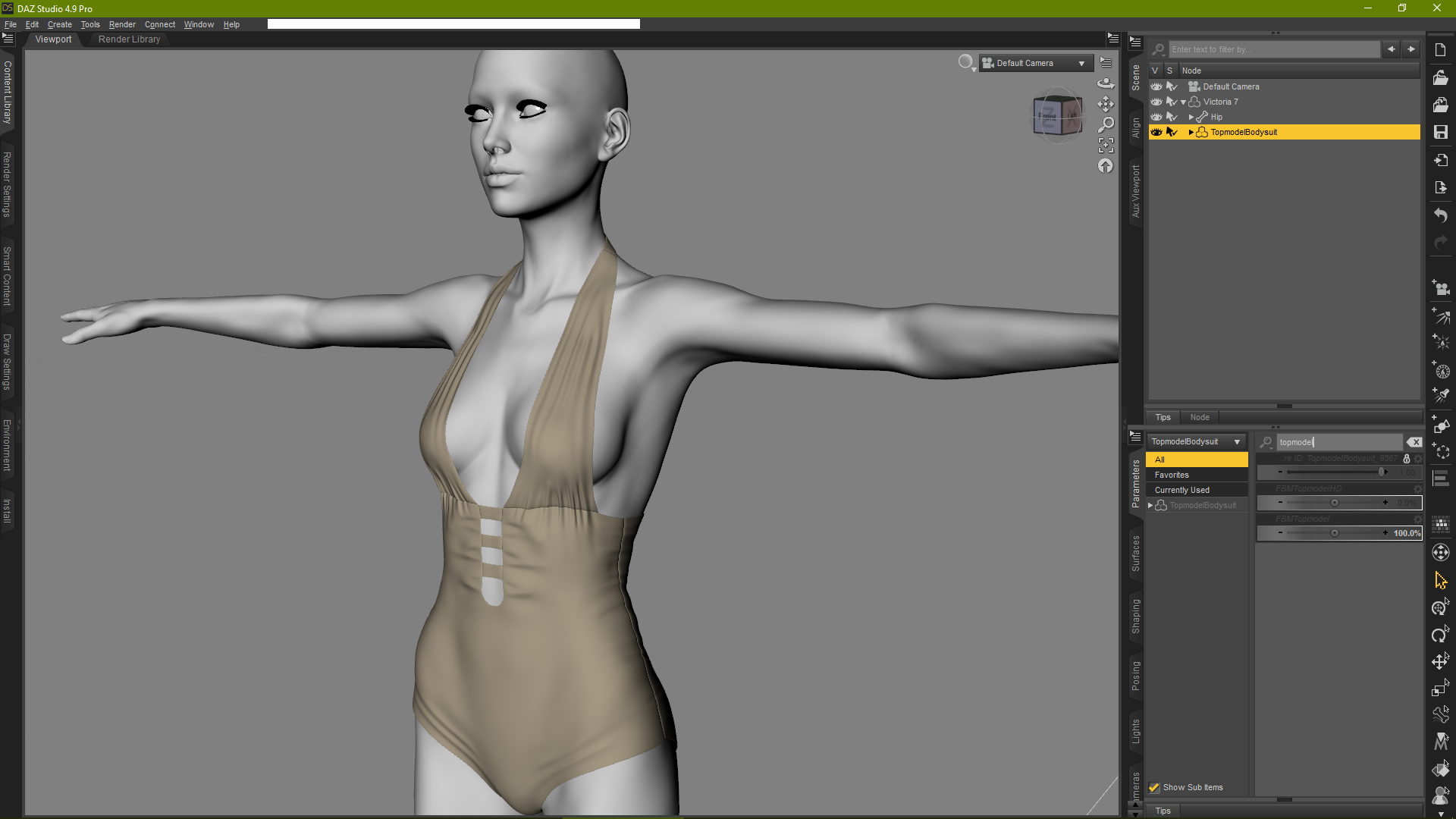

    Screenshots at Subd 4 for both figure and clothing. Smoothing off.
    Without dialling Topmodel HD Morphs on V7:
    Without Topmodel HD morphs
    After dialling Topmodel HD Morphs on V7 at 400%
    With Topmodel HD dialled on V7 at 400%

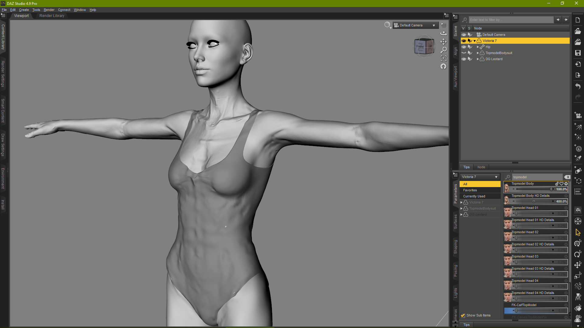

  • Sensual ArtSensual Art Posts: 646
    Here's another example of Topmodel HD morphs with Dance Gear leotard. This time with an outfit NOT specifically created for Topmodel HD. Using DG's default smoothing params. V7 at Subd 4 as before.
    Before dialling Topmodel HD morphs:
    DG outfit without Topmodel HD
    After dialling Topmodel HD morphs at 400%:
    DG with Topmodel HD at 400%
    In both the examples above it is apparent that HD morphs from characters can/do project into clothing.
    That's not HD, that's a projection morph. HD doesn't not project into clothing, so it needs a projection morph to tell DS where those morph deltas actually (approximately) are.
