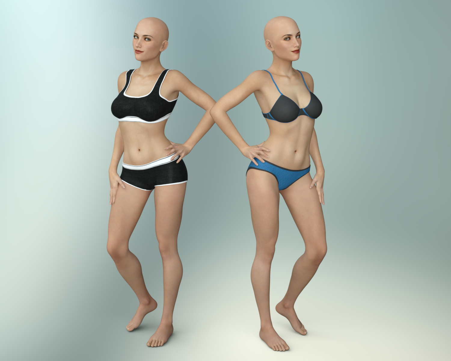

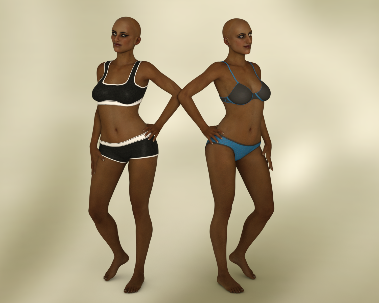

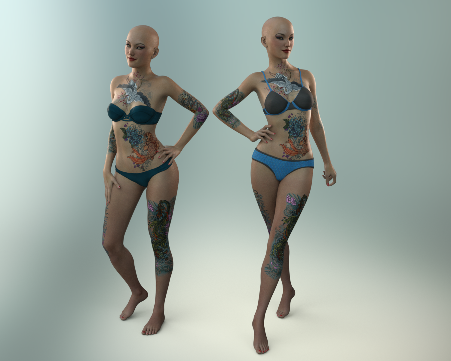

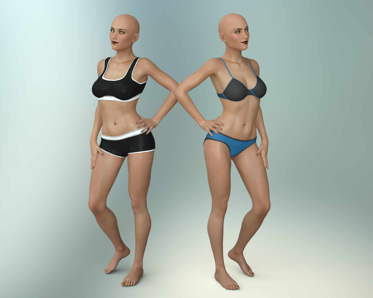

    Here are a few test renders I did. G3F on the left, G8F on the right. (Click and zoom in for bigger pics and more details.)
    MRL Eden
    Pix Mitsuko
    Draupadi (head and body reduced slightly on G8F version to match original more closely:)
    And here's MRL Eden with the Lain's Dual Lobe Shaders script as well (adjusted translucency weight to .60):
    1500 x 1200 - 1M
    1500 x 1200 - 1M
    1500 x 1200 - 1M
    1500 x 1200 - 1M
