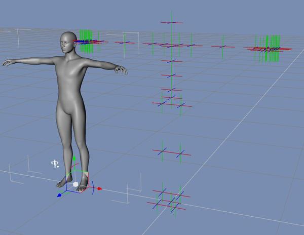

I used maya to create a human skeletal system, and I export it as an fbx and import into carrara. The problem is when I import it into carrara it is totally screwed up. Is there a way to fix it and if there is another thread like this I couldn't find it but I'm bad at searching on here so if there is point me towards that direction.

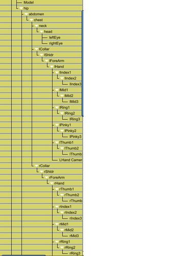

    Looks like a hierarchy problem can you compare the bone list and hierarchy from the maya fbx to the hierarchy the way it imports into carrara ??? I know sometimes with other 3d apps this is critical. I attached a jpg of a hierarchy of a cr2 I imported into Daz Studio and exported as FBX you can also get the free FBX autodesk convertor at their web site it converts certain auto desk formats to different version of FBX pretty useful hope that helps a little best of luck Mulls

    No the hierarchy seems to be right I think.

    I guess I'm not sure of the advantage of trying to bring a Maya rig into Carrara. Do you have some BVH Data you're trying to use? Is it an animated BVH file?
    Perhaps the issue with the rig is scaling, or as mullhull alluded to, it might be the FBX version. Wendy has quite a bit of experience with FBX import/export to different software, but maybe not with Maya. She's "Down Under," so I'm not sure when she will see this topic, but give it some time and I'm sure she'll have some suggestions of things to try.
  • WendyLuvsCatzWendyLuvsCatz Posts: 41,765
    in the C8.5beta you can use animation, zero figure
    it also does FBX import better.
    otherwise manually setting all the joints rotations to zero sometimes works.
    I have only imported FBX figures made by others from sites like Turbosquid, most work after straightening joints out or if they have animation takes
    exported seperately from Autodesk FBX converters animation take splitter as seperate figures/files.
    not all FBX files are equal it seems though.

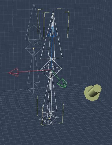

    Didn't come with a drag and drop interface unless I'm missing something, and nothing has change, but maya will import it properly. Daz studio gives me an error message if I try to export fbx I don't think any of my programs like .fbx very well. No wait daz did it this time but I get this (image) from carrara. The export fbx file from daz imports into daz just fine, but maya 's fbx format doesn't import into daz just fine. I try to import a .dae version maya exported and I get the 2nd image.

    I guess I still don't understand how Carrara's rigging is that much worse than the headaches you're having trying to bring the rig into Carrara. I've created complex rigs in Carrara and it's pretty straight forward. Besides, once the rig is in Carrara, you still have to line it up with the mesh and you still have to paint the joint influences. I could understand it if there was a specific rig you needed to use with some kind of bvh or other motion capture, or even a rig that was already animated, but if it's a custom rig made in Maya and nothing else.... To each their own of course.
    Try different fbx exporters/importers if possible as their are a few different flavors and from what I gather they all don't play nice with each other sometimes.
