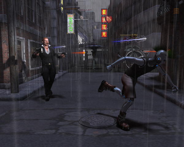

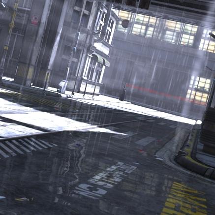

    I am not an expert with daz, however I had psy district on my wishlist, and bought it today.picture 1 is a default render with nada changed. I think it looks pretty good, with the exception of the lighting and perhaps the angle of the rain. The lighting at default is over-exposed and the rain, I would like to be able to adjust to the angle.
    The second picture I applied the light, fog, and rain effect to the hilly surround prop, and took the default lighting out, and replaced with predatron lights. I think the effect looks good. The default lighting on this scene looked awful with this prop. This is just an example of something you can do with this product.

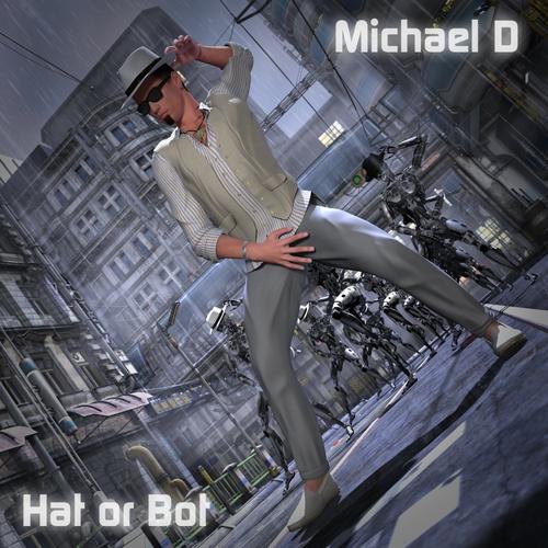

    Great (I couldn't test yesterday, had a render cooking. And about reflective, I just set reflection 15%-20% on the material, but use raytracing and lights that are getting reflected, but different materials require different settings, here is one with PSY district and one using FM rain and reflective grounds.
    Old renders btw (one from the RRRR contest)
