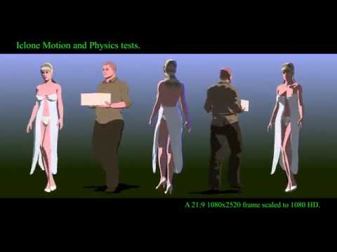

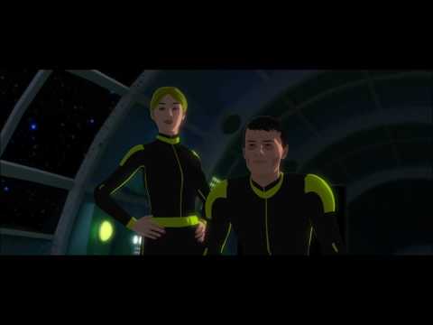

    I wish I could be more helpful, but I changed my whole meathodology, and now use Iclone merely as an animation/rendering tool, and then composite everything in After Effects.  Here is are some samples:
