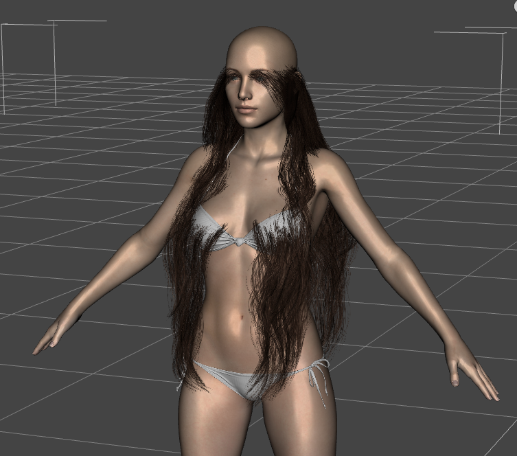

G3 Hair Misfits on G8 whose height is changed.
I had been having good luck autofitting G3 hair to G8, to the point I hadn't been buying G8 hair during early experiments.  Then I wanted a short G8 character, and used the Actor / Real World / Height morph.  Autofit failed big time.  As G8's head went closer or further from the gound, the hair seems to shift twice that distance.  Below, you have a short base G8 with G3 Olenna Hair.  The shorter the G8, the lower Olenna Hair gets.  I got the same result with two other G3 hairs.  I shifted to a G2 hair and got good fit results.  Anyone else see this?

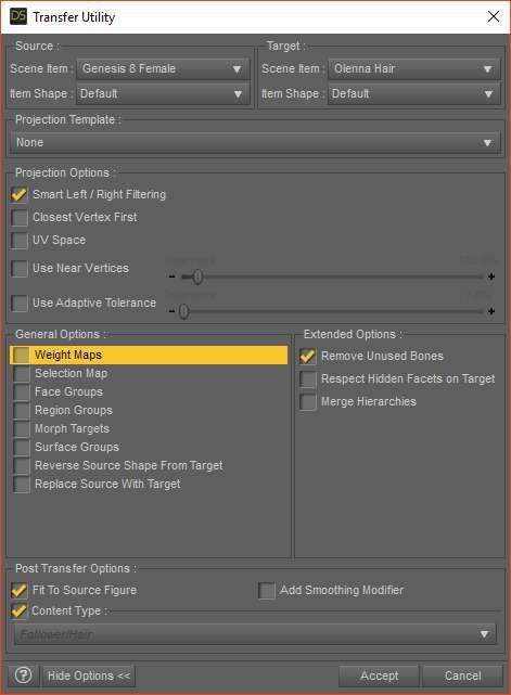

    Hi Blantyr, try this...
    1. Load G8
    2. Deselect G8
    3. Load Olenna Hair
    4. Edit > Figure > Transfer Utility
    5. do the settings below and click accept. (Basically set G8 as source, hair as target, and uncheck everything!)
    Olenna hair should end up fitted to g8 and can turn her head and work with Victoria 8 height :)
    Thanks to PA Kayleyss for this tip!
