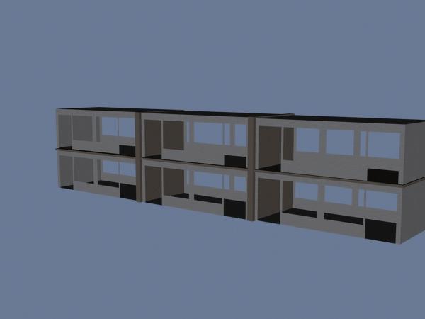

OK, I understand it now, If this helps someone else. Here in the render, this is a basic setup frame for a hotel I am creating to go into the scene. The one thing I have learned, (actually there's two), when in Hexagon, this is one room copied five times, the room divider copied once and the floor divider is just lengthened enough to cover the area, in Hexagon DO NOT make them into a group. I saved it as it is, seperate parts so each has its own characteristic then exported it as an object in Hexagon. Re-opened the object in Hexagon, as an object all the parts become one, still with their own characteristics, then sent that to Daz. and everything stayed exactly.
The second thing I've come to understand, in Hexagon, the loops I made to cut out for the windows and door frames, the mistake I was making before was cleaning up those loop lines. DO NOT clean them up, leave them. When you unfold the object for the UV, you can select each part face to adjust the checker to make sure they all fit the same. BEfore now, I was taking out those loop lines and when I sent it to Daz, Daz responded by trying to close the lines (those diagonals I kept getting). IN this, if I had gone ahead and cleaned up those lines there would diagonals all over the place. And If I had grouped everything they would all have one texture.

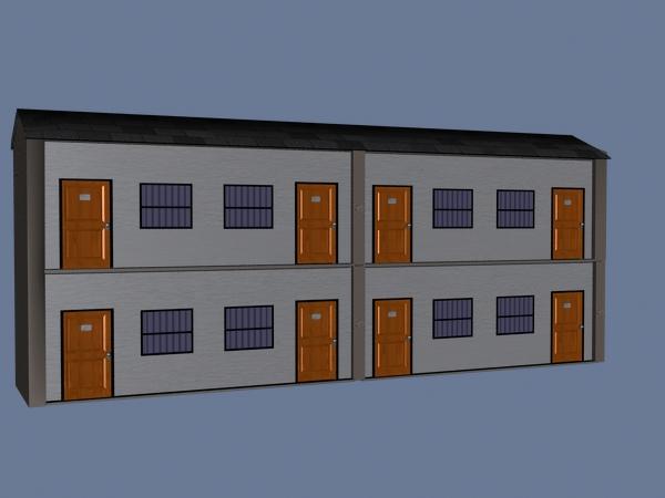

Went back and re-worked it, using Room Creator door and window as a model for size and to cut out the frames for each. Then created my own doors and windows and roof (the roof texture I found on the net, same as the door wooden textures). The curtains is where I learned to keep cutting the rectangle and "squeeze" every other loop to get the effect, Daz adds the smoother.
Again, NOTHING was grouped in Hexagon, and did not clean up any loop lines, but re-applied the texture in the UV properties each time I made the loop cut. Saved all of it as a single object in Hexagon, then re-opened in Hex and sent the object to Daz. Then in Daz take the smoother off the doors and give them the skin lighting model. Then the final step before saving this as a prop in Daz, I bring in M4 to check for size, if clears the door, etc. And since learning how to set the XYZ values in Daz, it really helps in Hexagon.

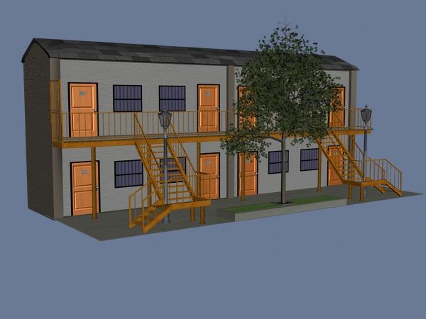

...and finally completed. Changed the textures on the stairs to match the doors, and changed the street lamps to a nicer metal texture I found, which worked out accidently in how arranged itself on the lamp. Then added the tree from Urban sprawl (hopefully the rez is low enough to not give me trouble), and created the plant box.

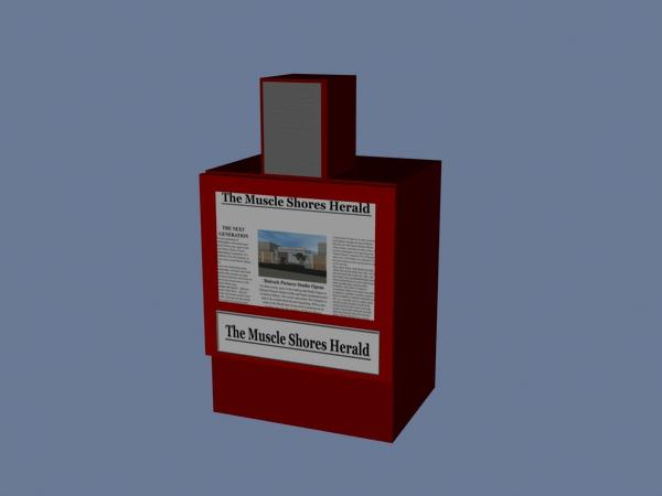

And as I have come to understand the programs a bit more the easier it's getting to create the layout. And create things like the billboards, a newspaper box to go with MacLean's Diner. I had put the two boxes from Urban Sprawl in front and realized a newspaper box should in front also, after all it IS a diner. So I created one in Hexagon and it's then I came to understand about the loop lines and cuts.

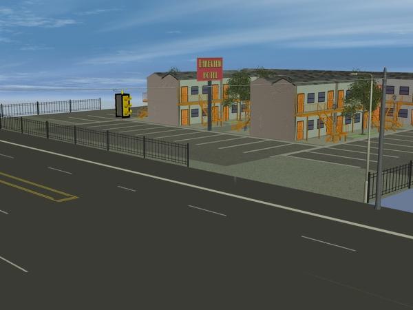

And finally the completed hotel, you don't get to see it enough in the video so here is the final layout. The buildings ALL done in Hexagon, as well as the sign, parking lots and the highway. The fence is from Urban Sprawl, and the hanging traffic light is MacLean, of course. I made it in to a 3 way light.
