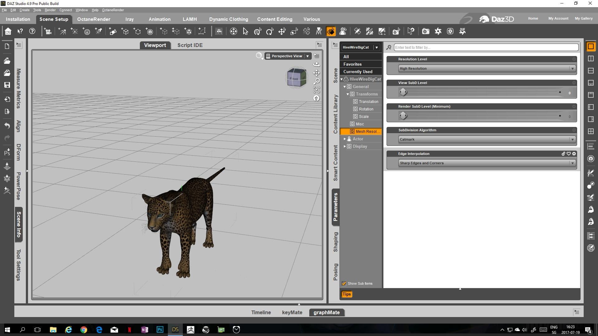

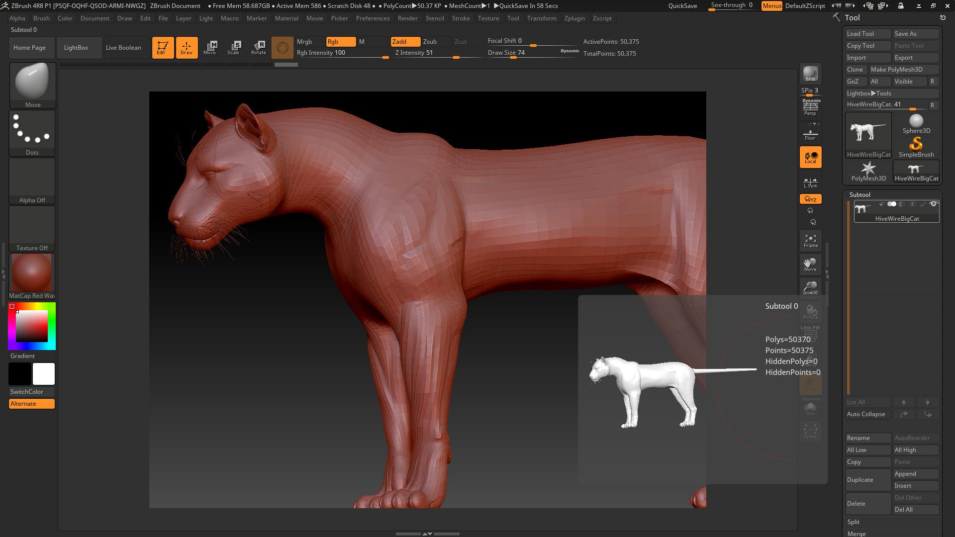

    After purchasing the HW3D Big Cat I was now able to confirm your observations as well:
    alternate shape morph for neck and body area created with "Move Brush":
    Confirmed.

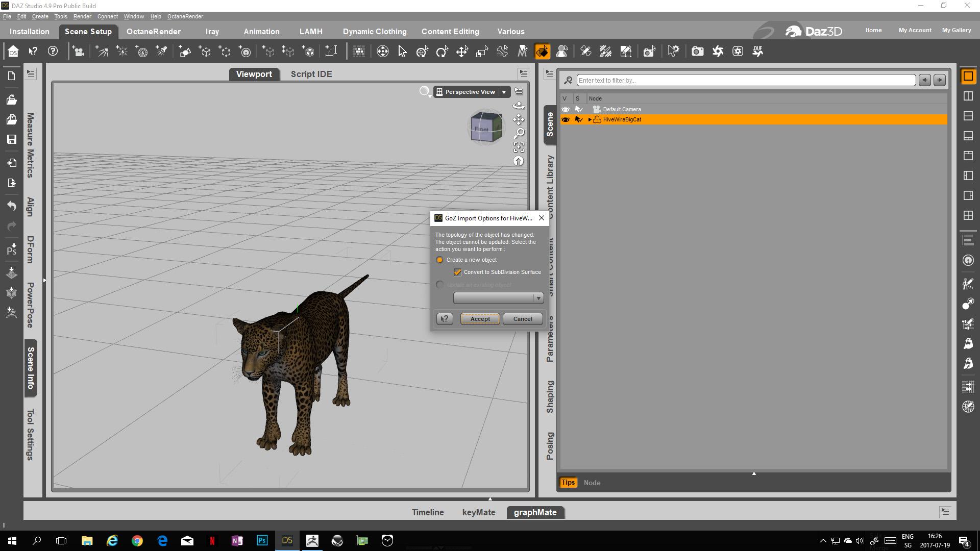

    For an unknown reason the HW Big Cat triggers the error message "Topology has changed" even when a proper workflow is used.
    - As far as I can tell the HW Big Cat does not seem to have any additional subtools.
    - The point count remained at 50375 points during the whole process.

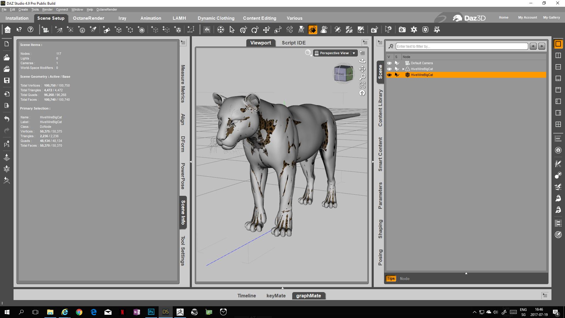

    - When you choose to create a new object in the failed GoZ import options and compare it with the original one the vertices, triangles, quads, faces count is indicated exactly as the same in the Scene Info tab
    Point Count of the original object before GoZ:
    Point Count of the imported morphed object after GoZ morph creation failed and a separate object is created:
    Tried this at least 3 times with 3 different morphs in different body areas.
    -> Same result: Topology Error message.
    Other objects are working without issue for me.
