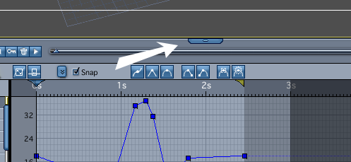

    To change the graph size select the graph editor.
    SEE IMAGE#1

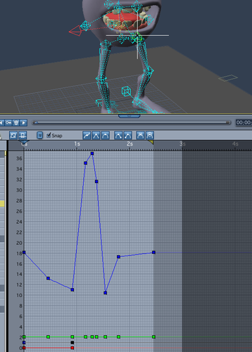

    To change the interpolation use the tweener to change settings.
    SEE IMAGE #2

    For the Graph editor, have you used the little blue widget between the Timeline and the scene window? You can expand the editor upwards (and squash the scene window) to view it better. You also mentioned the zoom tool. You my have better luck with it if you expand the timeline window upwards.

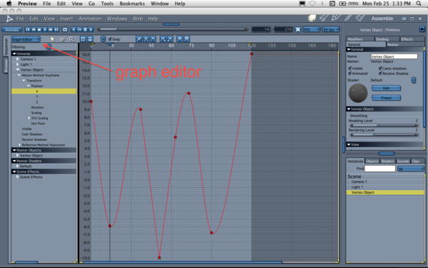

    To set the default tweener, go to File-->Preferences and use the pulldown menu to select General Scene Settings. At the bottom of the window it should say, Tweener and give you a pulldown menu with a list of available tweeners. From what you describe, it sounds as if you want Bezier.
