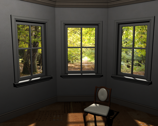

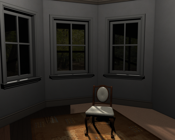

In this image I have created a plane primitive and applied a forest .JPG texture to it. I have a "sun" coming in though the windows (a distant light behind the plane) and a single, overhead point light in the room (as if a ceiling light)
But how can I make sure my forest looks like a bright daytime?

    I would use a Spotlight above your Set Aimed at your plane Set it to a Wide spread so all the Plane is lit up. Then Adjust the settings of the Spotlight as needed to match your Render.
    EDIT: I notice that your Plane is Very close to your Prop, you will need Room for this method to work. Adjusting the Size of your Plane to look proper might be needed. And even a Different image or a ReSized image to prevent distortion.

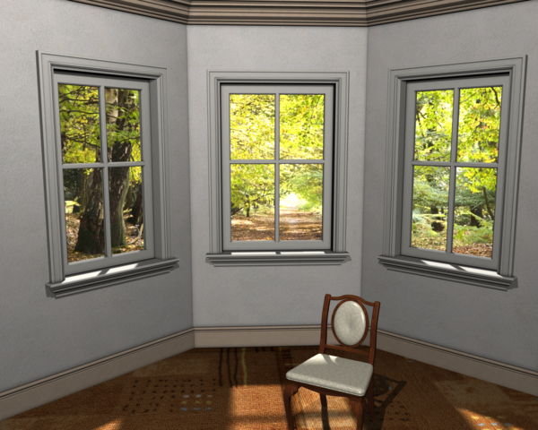

    I would go as far as to say the whole lighting setup needs looking at. For daylight, it's very dark inside the room as well as outside. So, here's a few tips and pointers for getting a good light setup. This assumes you're working with the default 3Delight render engine.
    1. Use multiple lights
    Don't be afraid to add in extra lights aimed at specific points of your scene which are darker than others. For example, you could use a spotlight for the background, and widen the cone so that everything is covered.
    2. Distant lights can pass through everything
    If you want a light which covers the entire scene then any distant light with no shadows enabled will pass through solid walls. If you position it up high, or even from below, it will light up every face in its path. Moving the intensity slider will help you to control the amount of light in the scene.
    3. UberEnvironment
    This is a very powerful type of shader lighting, so only use one of these in your scene. These support image-based lighting (IBL) as well as providing an ambient light across the entire scene. You can also use some nifty features like directional shadowing from IBL maps and Bounce GI, though the latter can really amp up render times.
    4. Ambient Strength
    Ambient strength is a very useful tool for 'fake' lighting. Essentially any ambient surface is self-illuminating, meaning that it will keep itself lit at all times. The amount can be adjusted via the strength slider, and you can change the ambient colour to match your scene, though white will work for most things. Using this on your planar background, for example, can give you a full-bright background without needing to worry about other lights.
    There are dozens of other ways to add mood to your lighting, but those are some basics to get you started. It's one of the more in-depth parts of working on a scene, so practice makes perfect.

    Brilliant! Thanks. Here's how it worked :)
    919 x 735 - 992K

    4. Ambient Strength
    Ah, ambient strength works a treat. Didn't know objects could light themselves.
    Cheers
    And thanks for the idea of using a distant light with shadows off to light up the interior a bit. Never thought of that! Here's an improved version looking much more like a real Summer day
    919 x 735 - 1M

    That looks good Sertorial. I would've suggested the Ambient change as well, so I'm glad HeraldOfFire already mentioned it. The lighting looks realistic, and since that's what you were after, it's a success. ;-)
