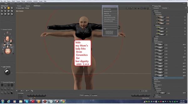

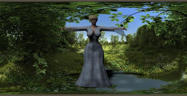

  • WendyLuvsCatzWendyLuvsCatz Posts: 41,734
    OK, tried a cr2 export of my late Mum facegen character in PP2012
    yes it works
    yes the aniblock importer works on her too!
    yes I can change texture poses!
    yes yes yes Mimic pro actually worked and she talks
    but clothing????????????
    saved also as cr2
    conformed
    transfered active morphs with DSON python script
    sits above her shoulders perfectly shaped and conformed?????????????
    Whaaaaaaaaaaaat?

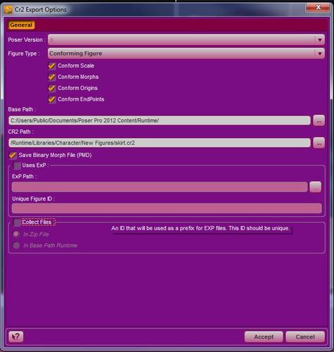

    these are the settings I used
    657 x 693 - 101K
  • fixmypcmikefixmypcmike Posts: 19,735
    I'm guessing that since you used CR2 export rather than DSON import there is no scaling factor.
  • WandWWandW Posts: 2,907
    In the parameters of the Body of the clothing check Include Morphs when Conforming and Include Scales when Conforming, and try selecting Follow Origins and/or Match End points when conforming.
    The Transfer Active Morph Script is for DSON imported clothing; I don't know if it has any effect on CR2 exported clothing...

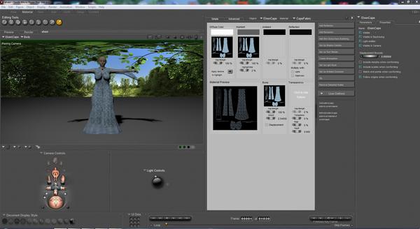

    lol. Dimension 3D's python script solved my woes but now a new one!
    textures
    I end up manually applying them but for an odd reason the elven cape is not rendering?
    920 x 475 - 410K
    1908 x 1044 - 474K

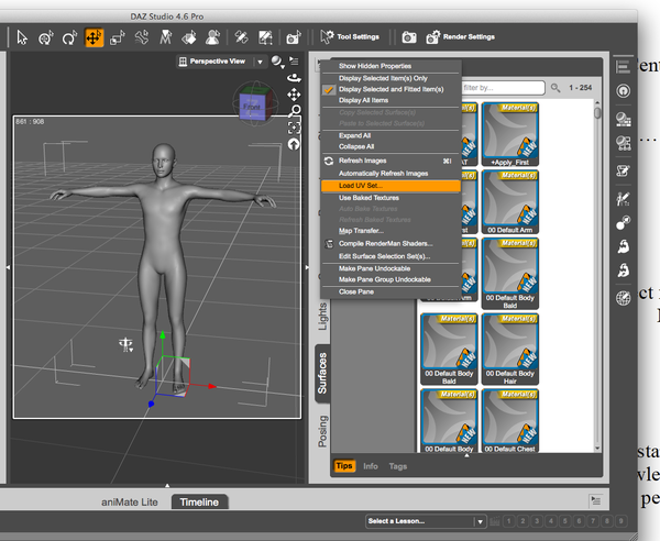

  • estheresther Posts: 641
    you have a great memory. I did get that. Is it still applicable in the latest poser versions. I can't remember where i put it. what is the name of the file and I'll do a search.
    Thanks,
    Love esther

    Hi Cliff,
    I can't find the "UV set option"
    1082 x 887 - 246K
    do't worry I just found it.

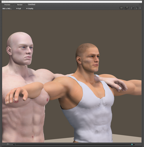

    I can poser skin it and change it's subdivision. Looks quite good subdivided in poser. I remember now that originally it was it's low poly look that stopped me trying to use it in poser when your tutorial first came out. things are different now and it looks quite good in poser.
    the figure behind is just a dson imported genesis. And the figure in front was imported into poser using the method in the tutorial by Cliff.
    ie directly exported from DS.
    1026 x 1044 - 681K
