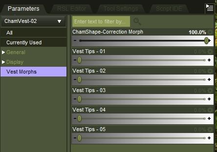

    In any case as I was waiting for help to come once again to the rescue! :P I started looking over Cham's various vests on Google and found the Dave Cockrum and Mike Grell version that I really liked the most. So into ZBrush and started with the older vest and well, I actually frigging succeeded it, I can't believe it.
    Put in 5 Vest Tip morphs and created a FIX morph for when Cham is dialed up fully.

    What Richard has tried to explain to you is that fix morphs aren't the way it should be done. It's not efficient to create additional morphs when they aren't needed. Best practice is to REPLACE the auto-generated morph with a hand made (or at least hand adjusted one) that isn't as vacuum packed. Richard has told you this as well as linked you to step by step tutorials on how to do it.

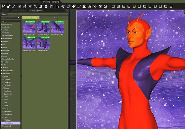

    OK... new issue. Got most of the elements done at this point. Figured out, thanks to your info on how to create Surface groups the boots are done, added in some boot morphs for different looks. So then I was thinking "WOW, finally almost done with this one" but nope. Seems that there always has to be SOMETHING that says "keep going"
    As you can see with Genesis arms up.... one side of the vest looks fine, the other side some how managed to get crunched. I looked into the Polygon Group Editor and the Weight Map Brush but all efforts fail. Just another area I need to know more about.
    Any help?
    743 x 787 - 347K

    YAY... figured it out.
    Here are the steps.
    1) Select the area in the clothing item that's causing the issue. In my case it was the rCollar.
    2) Tools>Drop down Tools options>Weight Map Brush
    3) Select the ZBulgeRight (towards the bottom there)
    4) Using a mixture of Brushing and using the Ctrl and Alt keys on the keyboard to alternate between Soften and Erase like magic it just flows right out.
    I still had an issue with how the vest conformed though on that side. So not sure what caused that but again with those steps got it looking like the other side. No one will know any different about what ever mistake or lack of something I did or didn't do. Live and learn!
    Yeah! Congrats :-)
