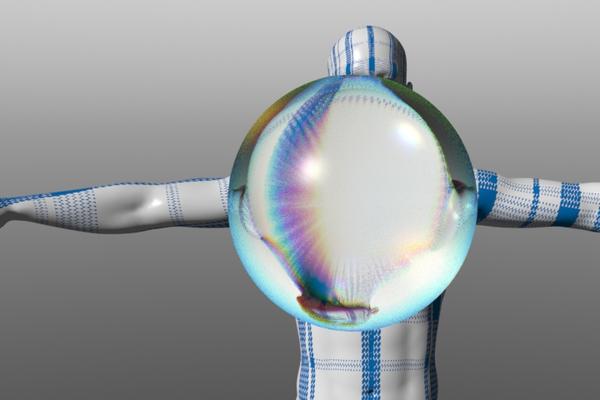

    I'm not sure I understand the issue - here's a "crystal ball" in modo, with 100% transparency and refraction. I can't check DS right now, but I know I have done the equivalent in the past (usually adding a touch of grey to the refraction colour).
    720 x 480 - 161K
    359 x 561 - 45K
  • Joe.CotterJoe.Cotter Posts: 3,362
    edited February 2013
    Well double checked in DS and yes, one can add refraction with 0 opacity. Below is a sample. Looking at the Modo image I notice there are quite more extensive controls related to refraction compared to what is exposed in DS. This also shows in the quality of the image with just adjusting available settings. As to what my post was about, I have seen a discussion on this topic over the years where in various render engines in the past it was necessary to add some small amount of opacity for refraction to work. This may not be true in any render engines currently. A lot of what I draw on goes back from forum posts on a topic over many years. Most times when I couldn't afford the software to actually play with it myself.
