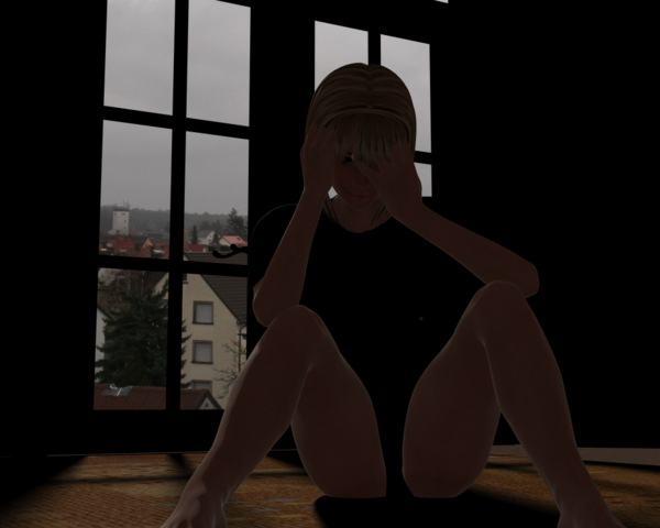

In this scene, I have a single distant light coming through the window (meant to be sun), but how do I get the interior to be lit by bounced light as it normally would be? It seems to only know how to do the direct light.
Am I making sense?

    Using the 3Delight renderer you'll have to fake it. By using non-raytraced lights you can get light which works through walls, allowing you to position distant lights to fill in the gaps you want. Alternatively, you can use UberEnvironment to provide an ambient light, or even get the bounce GI light using it. However, one thing to beware of is that Bounce GI using UE lights can REALLY amp up the render times. And I mean a lot. One render which took less than 10 minutes normally can take over eight hours with Bounce GI.
    Though that's just my own experiences. Luxrender automatically does bounce light since it calculates light based on real world physics.

    hmm.. Don't really like the Uber envrinoment light. It gives those weird mottled shadows. The first is my scene with the UE base added, so you can see what I mean.
    and this second picture is what you get when you add bounce GI to the UE base (not good). She looks like she's got light inside her!

    For UE you need to adjust things dramatically...starting with using one of the preset quality settings...3x or 4x. Then there are some settings under the advanced render settings that need to be tweaked.

    It only does that because your sampling rate is far too low. You need to find out how to use UE, lighting is a very complex matter, and you wont learn it overnight. You need to go to the Parameters pane with Uber selected in the Scene pane, and turn up the Occlusion Samples to at least 200, that should get rid of the mottling.
    There is also a Help icon available in the same content panel, it takes you here : http://www.omnifreaker.com/index.php?title=UberEnvironment2

    Use the 4x quality setting (there's a preset for it in the same folder as the Ue2 base) and turn the intensity down to 20% or so so in Parameters it isn't so bright.

    AHH! I had no idea it had settings!
    Thanks for this guys!
    Here's a render after following your advice :)
    919 x 735 - 911K

    Uberenvironment can give super results, but it is not really a new user light set, so you have done really well to get it working correctly.
    Keep at it, lighting is probably the single most important part of a scene, and it takes a while to get it right. It is worthwhile spending a bit of time finding out all you can about lighting, it can make a massive difference to an image. Well done.
