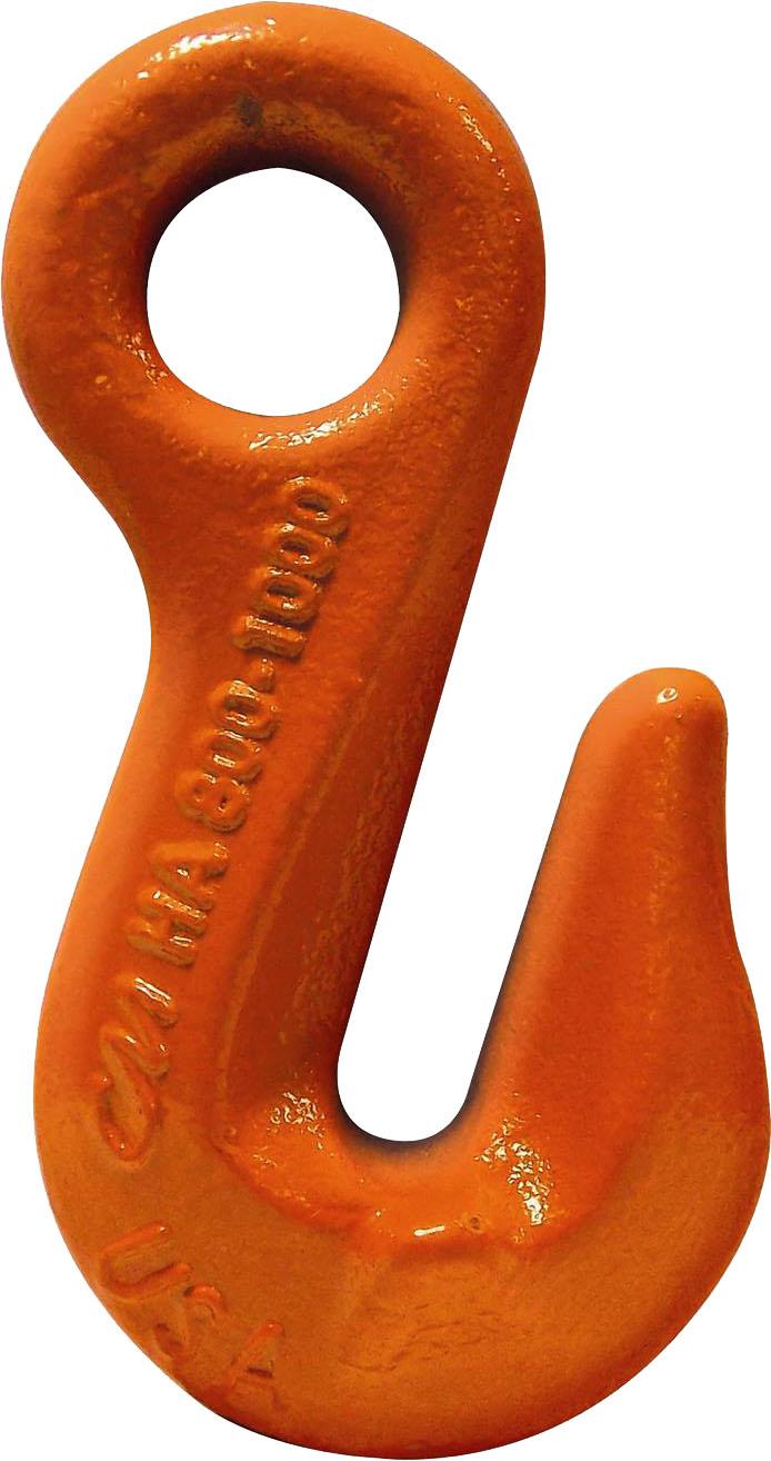

I’m having trouble modeling with what appears to be a simple object a Grab Hook (see Picture attached) but I haven’t figured out how to do it because of the shapes I know the sides are NOT flat.
I’m hoping someone can guide me on how to make it, so in the near future I can make several different style hooks based on the same design idea.
