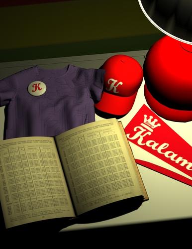

I am trying to light my scene by a desk lamp. I am using pointlights where the bulb would be (DS3). I had to use 4 just to get the brightness I needed, but the lamp is shadowing out and the t-shirt is putting out this funky tron texture. Needless to say it's not supposed to be like that. Here's the screenshot and the render.
Any help? Try to remember I am not real experienced with lighting so most of the technical jargon will allude me.
I appreciate ya'll :D

    OK ... I still needed 4 lights because the intensity only goes to 200 on each one, and I want no other light in the room. Removing the lamps shadow helped a lot, but I am still getting that odd pattern on the t-shirt. Can anybody tell me why and how to fix it?
    It must be a lighting thing because it isn't doing it on the same t-shirt in other scenes under different lighing.

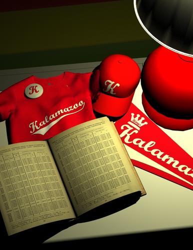

    It has to be something about how the light reacts to the dynamic fabric, because in the other scene where I use the same exact shirt, it doesn't do it ... it has different lights.
    Here is the same scene and lighting with the original texture. As you can see it still is doing it. I also am posting the other scene where you can see under different light that the weird pattern does not show up. Is it a dynamic thing, I wonder?

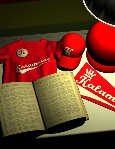

    setting the shading rate down to .1 got rid of the lines. Now for the lamp not looking like it's floating ... lol

    The .1 shading rate is working on the lines. Should I just keep it at that for all scenes to avoid the issue? Or should it be at 1.00 unless I experience this again for a reason?
    It's a time/quality thing...it will increase the time it takes to render, but they'll be higher quality...play with it to get the best balance, over all.

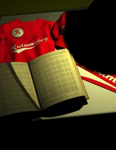

    Now, about the lamp shadows ... turning shadows off helped the shadowing out of key elements, but now the lamp hovers. Ideas? Would maybe a fake shadow made from black primitive circle, just a touch bigger than the base look about right? Or is there a better idea?

    You could try putting the lamp shadow back the way you had it, but also adding a second distant light pointing down from above with a very low intensity for ambient light. Enough to get light into the shadowed area, but small enough that there is still a shadow and it doesn't look too weird.
    You don't have DS 4 so you don't have the UberEnvironment available, but if you do some research I'm sure there are other better ways to provide indirect lighting other than a distant light as well.
