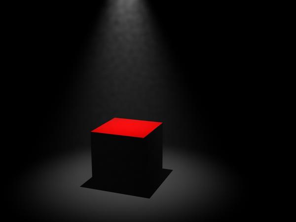

    well I figured out something, if I use a Spot Light from the shader mixer and just plug in the shadow brick, I can have the inner and outer angle parameters and set the light distribution between them (still working on that, need reread up on spotlights in the book)
    so if I use that light with the volumetric camera I get this..
    1024 x 768 - 114K
    IIRC Yacomo stated in the Global illumination thread that some ShaderMixer networks will not show up properly without a Shadermixer Light and Camera in the scene.
    Anything that requires photons...caustics and such, needs a surface, camera and sometimes light from SM. That's because the 'standard' DS cameras and lights have those features disabled...or more properly, removed. Basically with the photon mapper/caustics root settings added where appropriate, you get the 'standard' 3Delight lights/cameras...or at least that's what it looks like without seeing the actual code behind the bricks. All the volume effects should be 'visible' with a standard camera...
