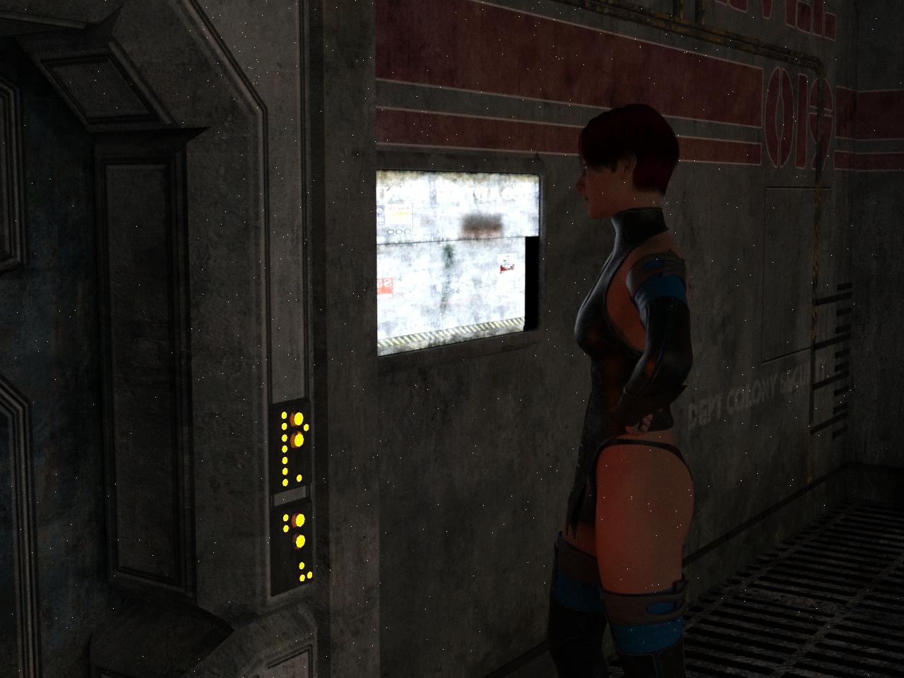

    Putting the .jpg in the emission colour was how I made this panel light up.
    Click on image for full size.
    1280 x 960 - 791K
