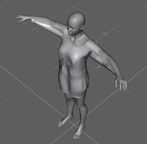

Hi I have a Baggy sweater and I'm trying to use the Transfer Utility to make it conform to posing, but it's shrink wrapping it to the Victoria 5 figure instead of leaving me with the original baggy shape.
I have have checked off the "Sources - Item shape to Clone Victoria 4" in the Transfer Utility and in "General Options- Reverse Source Shape From Target" which I learnt from a Youtube video, but it still hugs the sweater too close to the figure.
For this figure I'm only concerned with posing and not worried about other morphs. Should I be using another method to just rig the sweater to follow poses?
thanks for your time, dd

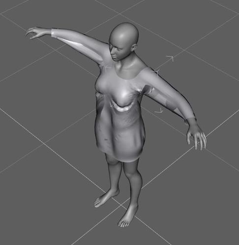

    Could you post some before-and-after screenshots? It sounds as if it ought to be working.
  • dee_dubdee_dub Posts: 0

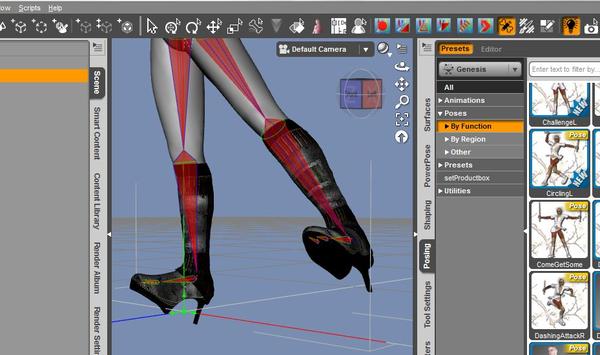

    So here are those pics. The 3rd pic is with another problem I'm having with footwear in general, and on close inspection the mesh gets messed up a little bit.
    About the first 2 pics, the first is before using the Transfer Utility and the 2nd is after. After using the Transfer Utility the Baggy Sweater hugs Victoria's breasts, an undesirable look. After all it's suppose to be a baggy sweater. Are there any other settings In the Transfer Utility I could play with? I played with a bunch, but after an hour or so gave up from frustration.

  • BejaymacBejaymac Posts: 2,009
    1) DS will always add auto-generated morphs to an outfit when it can't find any, these are "shrink wrapped" morphs that are completely ****in' useless for most things, as you have found with your sweater. The sad reality is that if you convert or make anything for Genesis then you have to make the morphs in a 3D modeling program, and not rely on the crap morphs DS makes.
    2) Converting footwear is hit or miss, mostly miss, it all depends on how it was designed, if it was build around V4's default T pose then it has a chance of converting, but most weren't, they were designed how you would see them in the shop window, and V4 has to be force fitted into them. These will never convert as is, they need a fair bit of manual work before they will fit Genesis, fortunately there are a few tutorials kicking around the forums on how to do it.

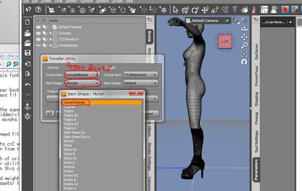

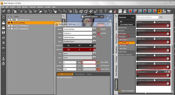

    1 when use transfer utility for boot or heel etc,,
    first I transfer V4 clone morphs to product boots (or shoes).
    it need tweak hide parameter.
    select genesis, go to parameter tab, then show hidden option.
    You can find clone parameter,
    Hidden>clones. then serch V4 clone.
    click gear of Victoria 4 clone ,then open parameter setting,
    check on auto-follow,
    change max to 1. then check off locked. (unlock) click accept.
    2, load the product boots for gen on the scene. then fit to genesis. it is product for genesis.
    so it must fit genesis foot shape. some items may need foot poze preset, but do not use it
    for transfer.
    Now I use genesis supar boots (female)
    (thank much,, it always fit almost V4 boots,, )
    3 check parameter of the super boots,

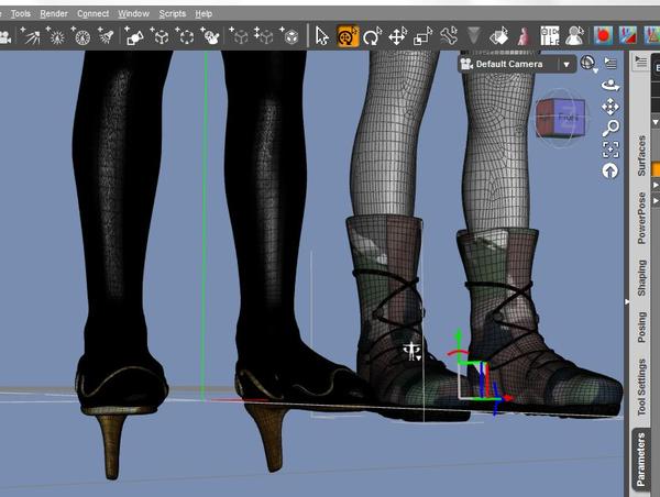

    Ok,,, I can find Hidden>clone>clonevictoria4.
    Now clone vicotria 4 morphs was generated from genesis to super boots.

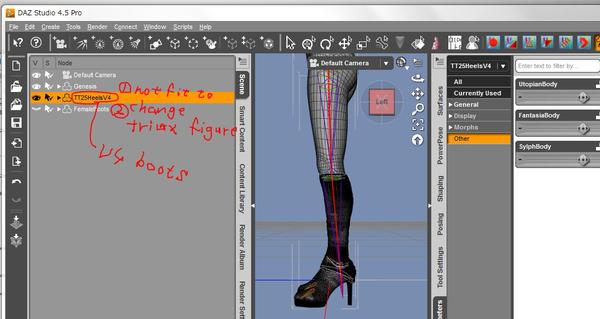

    4 deselect all. (not need fit-to)
    then load the V4 boots cr2 which you want to modify.
    select V4 boots, then from top menu edit>figure>rigging>convert to triax figure.
    it can keep the morph of original.
    and when use transfer utility we need to change triax figure
    or export obj, but on this case,,I hope to keep original morph.
    5 Now transfer rigs and weight-maps from superboots for gen to V4 boots.
    scene tab option , Assets> transfer utility
    Source Scene items = superboots (for genesis)
    itme shape = morph
    then serch "clone victoria4"
    Target Scene items = V4boots
    item shape = default
    check on weight Maps, Slection Map , Face Groups,
    Morph target, then click Morph target> Extended options >check on Source Mprphs
    then must check on "Reverse Souce Shape From Target"
    need not Fit to. check on Add Smoothing Modifier (I will remove it)
    7 when you transfer,, first it seems broken, but no problem.
    go to parameter tab, then general>misc> "fit to" genesis,
    and the shoes are already applied smooth modifier,
    check general>Mesh smoothing
    change smoothing type to "generic"
    it is useful when use transfer utility , generic not cover mesh of genesis.
    but smooth the mesh.
    (before,, other user taught us it can useful for modify V4 mesh when pozing,,
    in this new forum,,, I have used the generic type, whenever use transfer utility ,,,
    but can not use hexagon bridge,, after set smoothing .. )
    set smooth iterations from 80 to 120 may work about manycase.
    ( if the boots need not so smooth,, more low value may ok. I usually check
    wired shading view ,,, it is useful when check mesh )

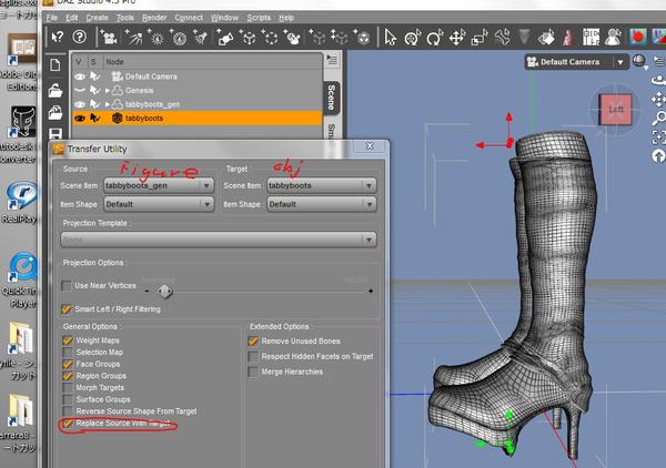

    then scene tab option> assets> transfer utility,
    11 Scene item tabbyboots_gen (figure)
    item shape Default
    then check , Replace Source with Target.
    no need tweak other option. it simply replace the figure by smooth shape obj.
    with keep the morph.
    12 after fit to genesis, check with some pozing.
    then save it as figure (same name before I saved)
