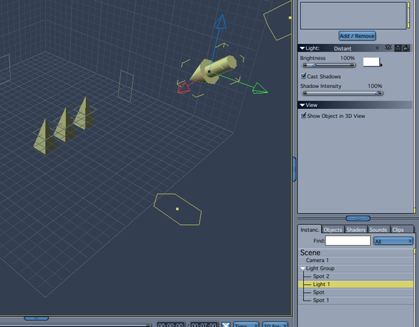

    One last thing; It the light you select is a "Distant" light, you can simply Edit > Send to Origin which will place the light at coordinates 0,0,0
    Distant light are not affected by position, just rotation - so you can do that with them without changing their effect on the scene.

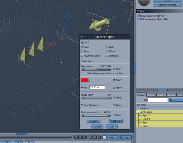

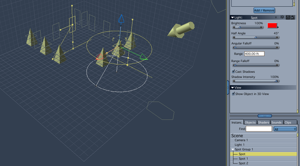

    To change the lights all at once, select all the ones you wish to adjust and go to Edit-->Master Light. I window will open where you can include/ exclude light types, settings etc.
    The other possibility with DTs set, could be the use of replicated lights. If it's a replicated light, you only need to adjust the main light and all the replicated lights will change as well. I don't know if he uses replicated lights on his light domes though, as I don't have the product.
    Do you know if there's the possibility to have more than one such setting? I went in to use that once, and was wondering if you could have Master light settings for Distant lights, for example, and other settings for the spot lights? Just curious is all. I couldn't figure out how to do it - but I forgot to look further into it.
    I'm like you, I tend to group my lights if I have a complex scene. Once they're grouped, select the group and and then select Master Light from the Edit menu. If you have spots and distance lights in the same group, but only want the spots to be edited, then disable the other check boxes. You can also check and un-check the other functions.

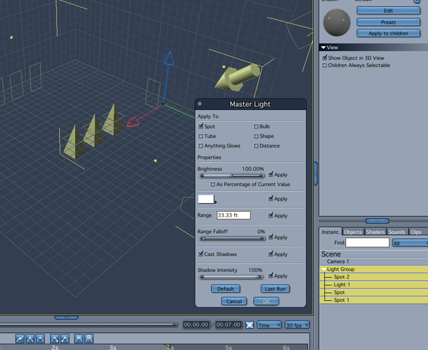

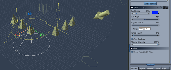

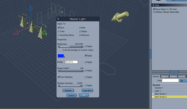

    But the Master Light doesn't care if they're in a group or not. It affects all of their type - I think. I've tried making setting for a distant lights, then opening a new instance of Master Light for use with Spots - but when I tried it, the Master Light settings remain global. However you change it, it stays changed - across the board. Or can you actually have a separate Master Light for each group?
    It only effects lights that are selected. If you have a mix of spotlights in your group and distant lights, and you only have the spotlights selected, then they will be the only light type that is changed. If you have another group with spotlights, and they are not selected, they shouldn't be changed.

    The Master Light remembers the last state it was in, so you have to pay attention to that. You don't have a separate Master Light applied to each individual group.
    Edited to add: If it helps, think of it as a batch adjustment to your lights. Master Light is the control panel that allows you to do it.
