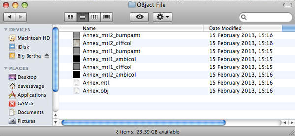

  • Dave SavageDave Savage Posts: 2,433
    That's odd about the .obj not sending the materials.
    Didn't it save a .mtl file?
    Here is an .obj file and all the stuff Bryce created to go with it that I exported the other day while testing a model I'm building at the moment.
    675 x 310 - 74K
