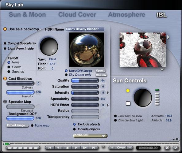

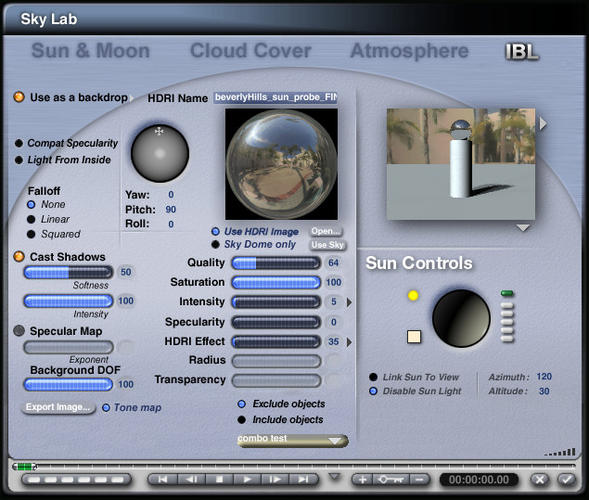

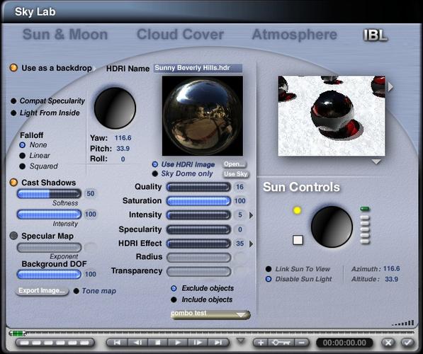

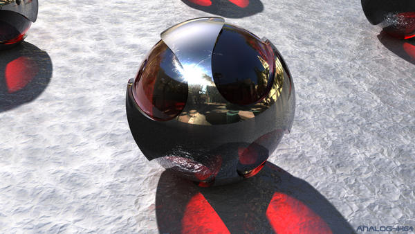

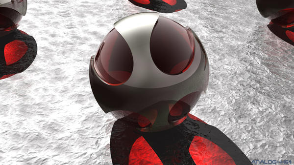

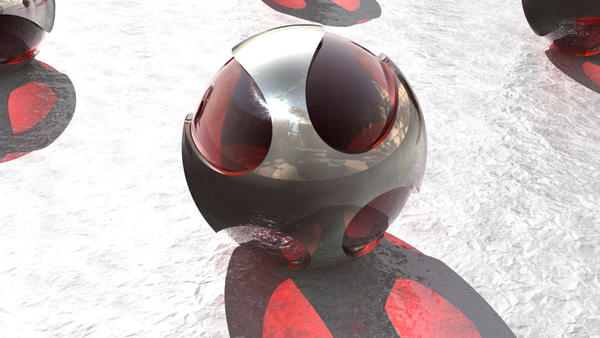

In another thread, David Brinnen suggested I try doing some HDR with one of my Images and here are the results.
First image is the Original Render.
Second image is the HDR version with "Sunny Beverly HIlls.hdr"
Third image is the settings used.
In the HDR version the metallic pitted ground now looks like its water.
633 x 531 - 125K
960 x 540 - 615K
960 x 540 - 411K

  • GussNemoGussNemo Posts: 1,855
    The outer shell has a more metallic, polished, look using the HDRI. Personally, I like that look better, along with the now looking water.
  • HoroHoro Posts: 11,739
    Looking good. Turn down Saturation. There's a lot of blue coming from the sky, hence the water-like appearance.
  • Dave SavageDave Savage Posts: 2,433
    I'd also be tempted to turn the sun back on (when you load an HDR it automatically turns the sun off), that way you'll get your nice shadow and light shining through the red glass back like on your original. You may then need to mess a bit with the intensity and HDRI effect controls.
    The HDR reflection certainly adds something though and looks great.
  • Analog-X64Analog-X64 Posts: 110
    As per suggestions, I turned the sun back on and played with the HDR settings in IBL.
    Metallic ground does not look like water, but the image looks washed out.
    630 x 531 - 134K
    960 x 540 - 437K

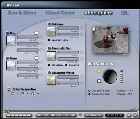

  • David BrinnenDavid Brinnen Posts: 3,136
    Yes it is a bit of a balancing act getting the light balance correct and knowing what setting to use when you introduce a HDRI to an already composed scene, but don't be discouraged, you will soon get the hang of it.
    If render time is a concern, remember to set the quality down to 16. Your HDRI is outputting no effect, which is fine and as a result you could turn shadow casting off in IBL and be sure to set the specular output to 0 too!
    Another thing to try, if you haven't (and to know exactly what is going on I'd need to look at the source) but do turn your Atmosphere off and set it to fully black. Then use "add to sky" option in the IBL tab. That will eliminate some of the causes of washing out potentially. Then consider modifying the diffuse and specular output of your main light source - which is now only complimented with the reflections of the HDRI image and no other light input.
    Key settings to be aware of that could cause washing out.
    Sun/moon shadows not being set to 100%
    Ambient response in materials (set global ambience to RGB 0,0,0)
    Skydome colour light pollution (set skydome colour to RGB 0,0,0)
    Just a few suggestions there.

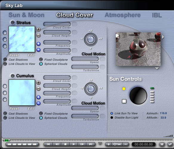

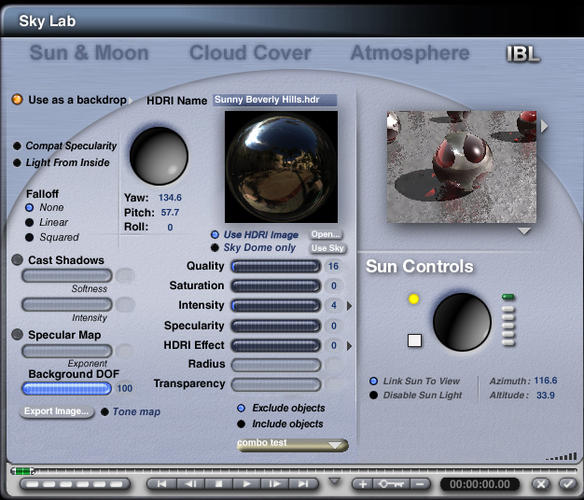

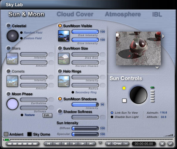

    edited February 2013
    Thanks for all the feed back and advice, its is appreciated and I'm actually having fun.
    Render speed is not a big concern, I have a previous generation Quad core CPU (Intel Core 2 Quad Q8400 @2.50GHz)
    This particular scene took 6 minutes 14 seconds to render, which all cores at 100% when Bryce is rendering. The original scene did already have all Atmospherics turned. I'm going to post all of the sky settings as well the current iteration of the scene.
    I wanted to see what "Link to sun view" would do, and it has changed the direction which shadow is falling.
    626 x 536 - 302K
    635 x 537 - 276K
    622 x 533 - 277K
    633 x 532 - 301K
    960 x 540 - 446K
    Post edited by Analog-X64 on

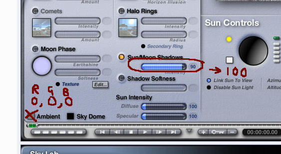

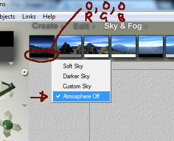

    Here then visually,
    345 x 281 - 66K
    563 x 309 - 94K
    Thanks for the visuals David, I misunderstood the RGB 0,0,0 to actual controls that would allow me to set values by typing them in :)
    So once I got the correct Sun/Atmosphere settings, the image became dark again so I increased the "Intensity" setting in IBL to 24 and here is the latest results, oh and I increased the Ray Depth from 6 to 12 in the render settings.
    960 x 540 - 636K
    If you hold the alt key down while clicking on the colour swatch (any in Bryce) then you can bring up a little dialogue that allows you to ender RGB values, or HLS or another one I can never remember and don't use.
    If you want to use soft shadows it is usually better to go for premium render mode, check soft shadows and also treat yourself to a bit of DOF while you are at it. I've provided tutorials to cover that option. The reason being that the render engine for premium rendering is different from the first three in the Render Options and will handle these things a little more effectively. 64 RPP is usually enough to achieve this effect.
    As for Ray Depth, it is rare to have any need to go over 6. I usually drop mine to 4 for most renders, unless I see a Ray Depth issue in the render, and then I lift it until it goes away. A ray depth issue would be a situation where light fails to make it through several over layered transparent materials or can't tunnel far enough down into a reflection to disguise the underlying blackness that haunts Bryce once the ray depth has been used up.

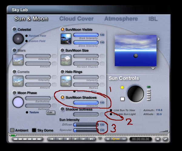

    @Horo If I turn off the sun, I lose the shadows and enabling "Cast Shadows" in IBL does not help either. I still have a lot to learn :)
    @David I'm re-rending the image at a higher resolution with a lower ray depth will see how long it takes.
    1 = this is the global shadow control - it is not well labelled. Turn this off and no direct light shadow are cast. This wants to be set to 100 for most renders.
    2 = disable the sunlight should only turn the sunlight off - not affect the shadows cast by other light sources (that's 1's job).
    3 = or set these values to 0 and you will have effectively disabled the sun.
    698 x 580 - 185K

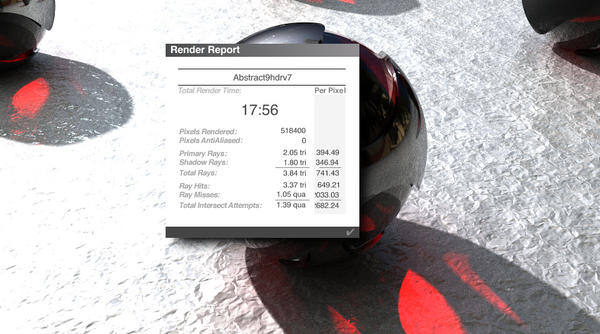

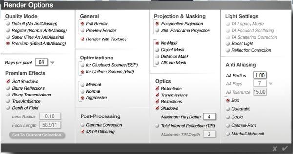

    I didn't create a new topic, since its still related to this particular scene.
    So I wanted to do a final render at 1920x1080 and it took slightly over 6 hours.
    Is there something I could have done to optimize the render time? or that's just how long a raytrace of this type is going to take.
    I'm including a screenshot of the render settings. and the priority was set to high so all 4 cores were running at 100% during rendering.
    I could setup network rendering with an additional 4 PC's running Core 2 Duos each. But I'm not sure if the overhead of rendering over a network would help me in this instance. since I'm not actually animating.
    668 x 352 - 76K
    Well... it all depends in this case as to the quality of light you are trying to achieve with the soft shadows. By and large, it is not efficient to use premium effects for just soft shadows. If you are in this position, it is often better to simulate the effect in regular mode using multiple light sources instead. Whatever you do though. Don't use soft shadows in regular mode as this will possibly take even longer!
    Optimising render times is something I specialise in, but I'd need you to send me the source to figure it out. If it is under 10mb you could email it to me. You might be doing it already by the best method, but without picking your scene apart it would take a long Q and A to get to the bottom of it.
    637 x 339 - 96K
