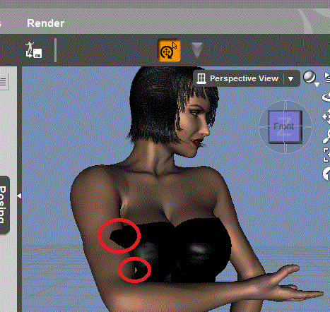

    the body suits or anything almost tight doesn't come out right, parts of the cloth is under the sking at the ; waist, under and on the sides of the breast, behind the calfs.. depending on movement. it's a V4 cloth i'm using on a Genesis Basic+ V4 modifier.. I had a feeling it would only turn out right on the V4 but I was wondering if there was something to tune it with since it's close to fitting. I would add pics to show what I mean but it might be counted as nudity since some flesh are comming out from under the cloths.
    I have autofit, it just doesn't seem to come out perfect, especially the boots the foot always stick out.

    Try adding a smoothing modifier to eliminate any poke-through. Footwear is problematic with autofit. because the default foot pose for Genesis is different from the one for the Gen 4 figures.

    Thanks smooth modifier took out 90% of the problem, I still get a few depending on the pose. Do you got any other solutions?

  • CyberDogCyberDog Posts: 232
    When you apply the smooth also set collision for the dress. Set it to collide with genesis. That should help stop poke through.
    Here is a youtube video by DAZ 3D showing how to deal with the problem :
    http://www.youtube.com/watch?v=gBGzfNgfdyo

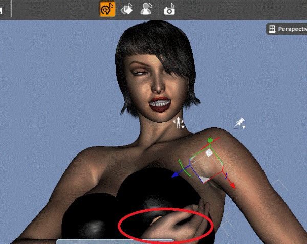

    You can't have the hand touching cloth that touches the body, because the cloth will try to collide with them both and end up clipping. Move the hand away slightly and that will probably fix the breast-area clipping in the second pic.
