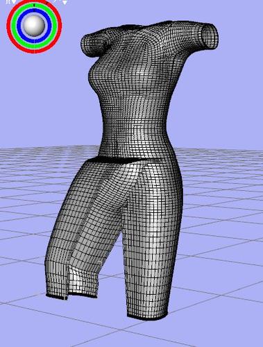

    Thanks wwes. Those links helped a lot, I was able to get a good skeleton in place, copy the dress geometry in, and delete the unneeded bones. Then created figure and the dress did in fact bend. The issue I now have is that the parts aren't welded together. So if I bend the left thigh part of the skirt it bends as if it's not connected to the other part of the skirt. See the picture. Also, the bends are very sharp. I copied the skeleton from V4 so I am not sure why the bends seem so much more harsh than hers.
    Some of the tuts say something like "export the object from studio so it will be welded before you do this" but I don't see how. If I do I either lose the groups or they are renamed to generic stuff like "group 1", "group0" etc.
    It's getting close but still can't make it move like a dress. Thanks for the help, moved me a lot further.

    Poser rigging doesn't allow two sibling groups to touch, so if your skirt has thighs that join that will give you the tearing you see - one solution is to make the skirt all hip, which the thighs can both influence. The falloffs always need adjustment on clothing, the copy from the base figure (V4?) is only to get the joint centres (which must match) and for a starting point.
