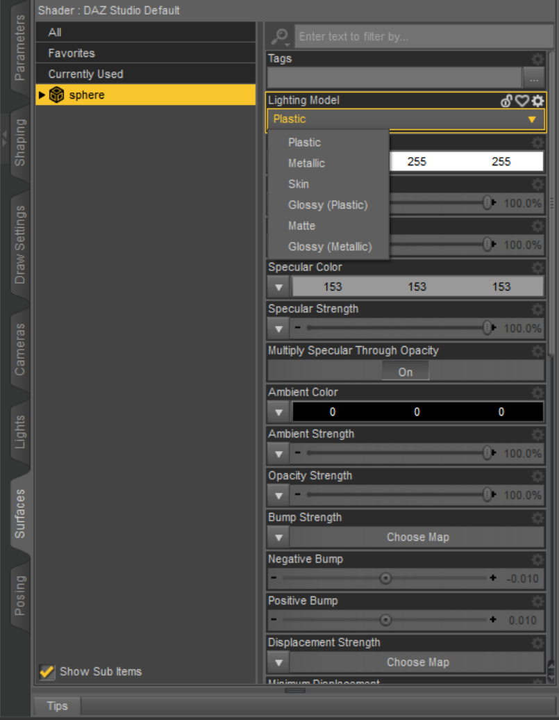

    In the default surfaces tab for items....
    There is a dropdown labeled "Lighting Model"
    Plastic
    Metallic
    Skin
    Glossy (Plastic)
    Matte
    Glossy (Metallic)
    Try changing it to matte
    805 x 1036 - 155K
    Post edited by JamesJAB on

    JamesJB, your suggestion appears to have done the trick in this instance. "This instance", by the way, is the image I am here attaching. The lunar surface is something I picked up from ShareCG. Indeed, it was set to "Plastic" and I changed it to "Matte", which fixed it, unless my ignorance is fooling me into thinking it fixed it.

    That shiny glossy moon was pretty crazy looking.  Looks like that fixed it up nicely.
