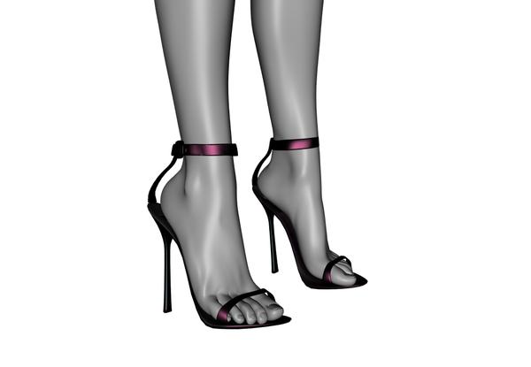

  • artistb3artistb3 Posts: 188
    V4 Platform Pumps by Idler from DAZ fitted to Genesis

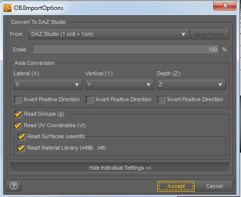

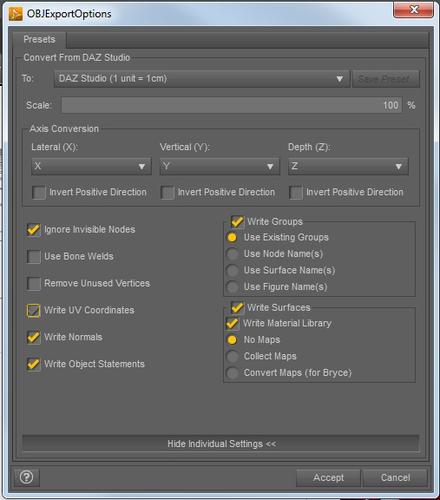

  • lface8lface8 Posts: 126
    Thanks for the tutorial, but I have a few questions, maybe you could help me out.
    1. "Export as an .obj file" - Which preset should I use? Daz obj, poser obj?
    2. "Now we need to fit Genesis to the shoe and/or the shoe to Genesis." Am I supposed to fit Genesis/the shoe to the original shoe or the obj? If I'm supposed to fit it to the obj or vice versa, how do I do that? I was under the impression that objs could only be parented unless converted to a figure.
  • wancowwancow Posts: 2,708
    unless you're exporting for use in Poser, never use Poser OBJ. That will rescale the OBJ.
    Always use DAZ Studio Export scale if you're working in DAZ Studio.
    edited February 2013
    The attached shows the OBJ export/import settings I use.
    I see the issue with the term "fit". Apologies for not clarifying step "Now we need to fit Genesis to the shoe and/or the shoe to Genesis". This is confusing. It does not mean that we want to use Autofit or that we want use General->Misc->Fit to on the Parameters tab. It means that we want pose Genesis such that the feet/legs fit neatly within the shoe(s)/boot(s) geometry. So it should read "Now we need to position Genesis to fit the shoe and/or the shoe to Genesis". If it is a shoe obj, then often it is a case of using the Rotation sliders to pose the Genesis feet/toes. After positioning, the shoe(s)/boot(s) are still not parented to any part of Genesis, nor have we "fit" them to Genesis.
    As an alternative to posing Genesis, the shoes can be posed using (Translate, Rotate, Scale in General->Transforms under the Parameters tab). If making any changes to the shoe(s)/boot(s), please be aware that you will need to re-export/import the shoe OBJ after the change.
    I have found it useful in many cases to both pose Genesis and to re-scale the shoe up some. So, whatever it takes to get the foot neatly withing the shoe/boot geometry, this is going to provide a better result.
