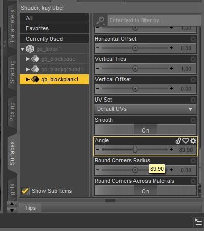

    All you need to do to adjust that to taste is select the Surface and adjust the Smooth - Angle to a number lower than the default 89.9
    An angle  number around 30-35 should give you what you're looking for.  a straight board like level surface.
    401 x 455 - 49K

    The issue is not in the geometry, There is shading on the texture map that is causing the floorboards to look warped.
