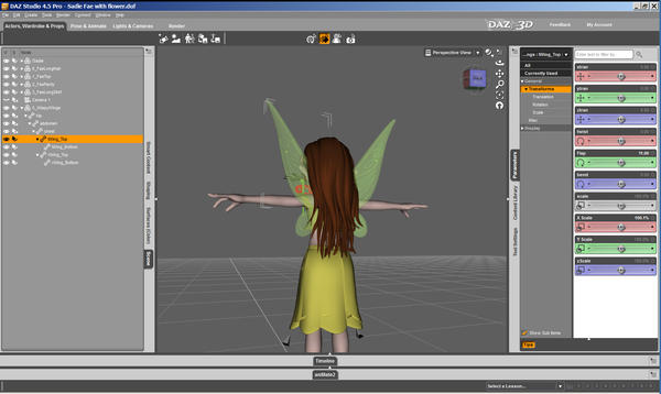

Still working on my fairy SadieFae and getting a little more proficient every day. I'm now back the problem of acheiving a repeated action with an aniBlock of flapping wings. I've re-read the advice offered in 'Are there any Daz Buddies', I have a good functioning aniBlock (Flapping) but all the attempts to get a repeating action fail. Inserting successive blocks and also stretching with no success.
What am I missing?
Screenshot attached

    Without knowing how your aniblocks are constructed, it's hard to tell. Does the flapping animation return to the first frame before moving onto the next aniblock?

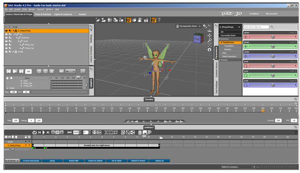

    Each wing is animated separately in each frame. The animation from closed to open is a 2 frame sequence and in my present setup covers 5½ cycles i.e. frame 1 = closed, frame 3 = open, frame 22(5½ cycles) = open. The track is Sadie and the wings are an add on. Both wings are animated in the lwing top node. Should I have a separate timeline and track for each node?
    The aniBlock User guide deals with this topic but I am missing something somewhere.
    1684 x 1006 - 315K

    At a quick look, if the wings are fit to Sadie before animating, then aniMate2 gets confused between what's a sub track and what isn't. In reality neither should be subtracks of course. If you can animate the wings before fitting, and then fit, you should see that the stretching the aniblock to repeat flapping should work.
    You will probably have to restart doing your animation, because aniMate is possibly confused by now.

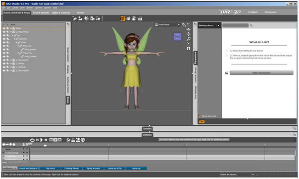

    Thanks for your comments Guys, I’ve started a fresh Character and noted where everything belongs. The Actor is 3D Universe Toon Girl Sadie with a Morph to create the fairy features. The wings are an accessory.
    I’m not sure what is meant by a few expressions used in your replies.
    ‘... if the wings are fit to Sadie ...’ The wings are an accessory of Sadie
    ‘....I believe you need more than one time line ...’ Does this mean an extra Track in aniMate2? If so I have created tracks for lwing and rwing.
    I have animated one flap cycle on each track, created an aniBlock from Studio keyframes, named it Flap Once and done a trial insertion in each of the four tracks. None worked and now the keyframes in the Timeline have vanished.
    As can be seen there are other aniBlocks which I created from standard blocks some weeks ago and each one activates if hovered over.
    To say the least I’m puzzled.
    606 x 364 - 93K

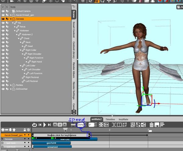

    That is how you know what an aniblock does before you use it in the timeline. I think it is a super idea. Is that what you meant?

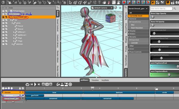

    Now I try as you did,,
    1. load dress only (it has two long side roin,, and I can move it by controller)
    in the scene
    2 set animation 0 frame to 30, it flip 5 times (xrotattion and twist ) per 1 second
    both of r-roin and left roin, as if bird (no meaning ^^;)
    3 make aniblock,, select root node of the dress, then open animate 2 tab, "create aniblock from daz timeline"
    I check on only rotation. save as Flip.fg
    4 first I clear scene, then check my Flip.fg
    load dress, then select it, apply new track
    set on aniblock "flip" on the truck yes it work.
    5 retrun zero frame, load genesis, then fit "dress" to genesis.
    6 select genesis, then apply new track (not sub)
    on the track, set aniblock (walk) for genesis.
    7 check animation
    8, if I want to extend flip animation,, click the flip aniblock ,then extend, now,
    flip animation of dress keep to 3 second.
    so that,, if you make aniblock correctly ,,for your wing first ,, (I think you need only one aniblock,, to flip both wing)
    and apply track correctly,, it must work,,,
    938 x 776 - 117K

    Sorry I've been absent but I'm back. Unfortunately I can’t follow your example (Now I try as you did) because the wings can’t be loaded alone however I remembered I had keyMate and gave that a go and my problem is solved, I have a working aniBlock. I still don't understand why my earlier efforts failed but I'm back in business. The screenshot will explain it.
    Many thanks for the time you took helping out.
