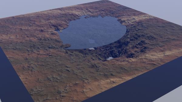

I would like to add a lake to my scene but can't figure out how to add the water to just the lake. Every time I add a water plane it covers the whole scene. I am adding just a plain lake form to my scene from the content in Bryce and want to fill it with water. Thanx for any help!!!! :P

    I. THE FLAT LAKE
    a) Create a 2D plane (I prefer circular), not an infinite plane.
    b) Orient the 2D plane so that it's horizontal. Re-size and re-position the plane so that it neatly fills the area of your lake.
    c) Add your water texture.
    You could use a cylinder, a cube, even another flat terrain equally well... So long as you're just after surface appearance.
    The example below shows my 2D circle incompletely covering my terrain cavity. The grey patches of the 'lake' is the grey infinite plane intersecting the terrain.
