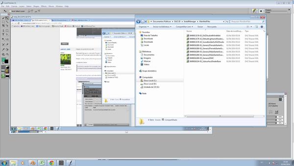

    When you get home, check DIM.
    Go to the Installed tab, find DAZ Studio on it, right click on it, and click on Show Installed Files. That will tell you what (if anything) was installed, and where it was put. These are also clickable links, and will take you straight to the installation folder.
    You can try running DS from there, or right click on the EXE icon, and select Send To > Desktop (Create shortcut) to put it onto the Desktop.
    It sounds to me like it did not install at all, but DIM will tell you. If you used the default install location for DIM, you should find a log file in
    C:\Users\Public\Documents\DAZ 3D\InstallManager and that may give more information.

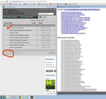

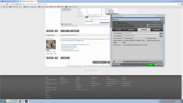

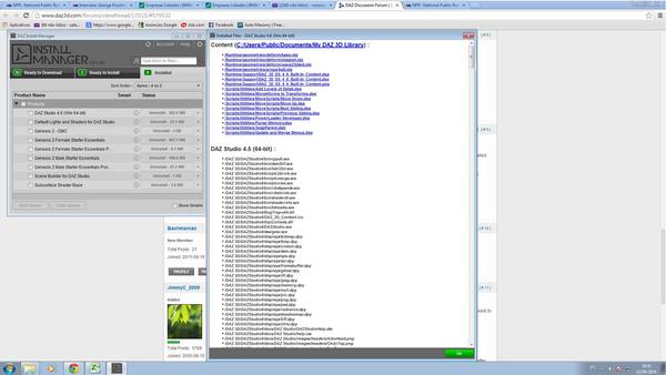

    It looks installed, but I can't find the icon.
    1921 x 1081 - 217K
    1921 x 1081 - 205K
  • fixmypcmikefixmypcmike Posts: 19,719
    It looks like it didn't actually install, as the list of files is grayed out for the actual program. Can you click the gear icon in the upper right (Settings) and post a screenshot of the Installation tab?

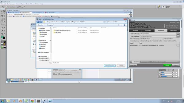

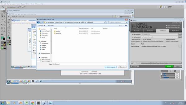

    Hi fixmypcmike
    There it is.
    1921 x 1081 - 135K
    edited April 2014

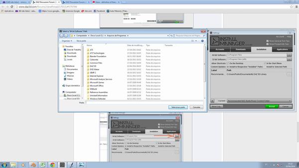

    The Install Manager is looking for Program Files, but your system is using Portuguese, so you may need to change it to
    'Arquivos de Programas' using the button beside the path to browse to the correct folder.as shown below.

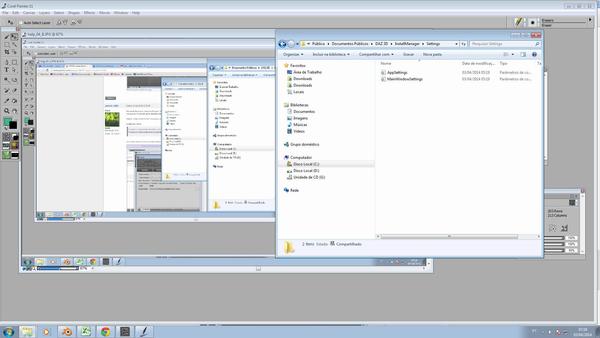

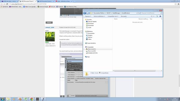

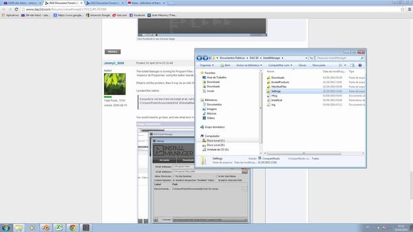

    If that is not the problem, then it may be an Anti Virus program that is preventing DIM from installing DAZ Studio.
    I posted this before :
    You would need to go here, and see what error messages there are in the log file to give us some clues.

    "The Install Manager is looking for Program Files, but your system is using Portuguese, so you may need to change it to
    ‘Arquivos de Programas’ using the button beside the path to browse to the correct folder.as shown below."
    That looks missing, the Anti Virus stuff is likely to doing that, though I have no idea how disable that in a secure way.

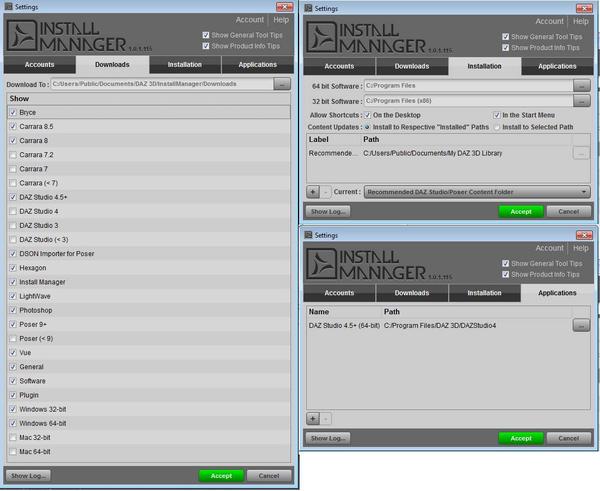

  • edited December 1969

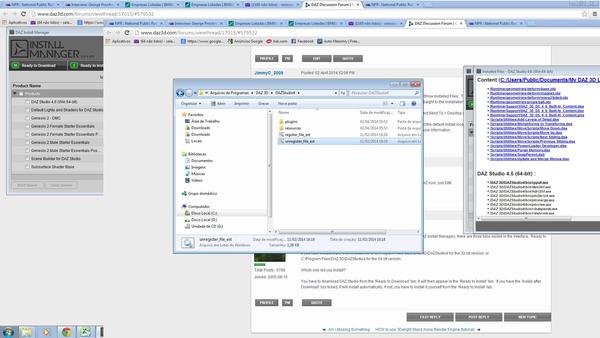

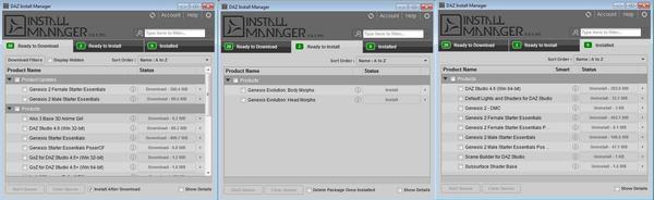

    "It looks like it didn’t actually install, as the list of files is grayed out for the actual program. Can you click the gear icon in the upper right (Settings) and post a screenshot of the Installation tab?"
    1921 x 1081 - 148K
    1921 x 1081 - 166K
    1921 x 1081 - 124K
    1921 x 1081 - 194K
    1921 x 1081 - 140K

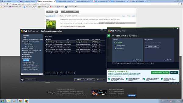

    On the Desktop, select the icon for the DIM, right-click, and select 'Run as administrator' from the drop-down menu.
    See if that works, if not, you may have to go into your antivirus software and allow DAZ Install Manager as a trusted application.
    You gouls use Google to find out how to do that.
    Exception done, I think.
    And then I do what?
    1921 x 1081 - 178K
    Now when you run DIM, it should be allowed to install DAZ Studio into Program Files. Program Files AND Program Files(x86), are protected areas in the Windows Operating System.
    If your exception does not work, the only thing I can think of, is to stop AVG until you get DAZ Studio installed, it only takes a few minutes, then switch it back on again. That may cause small problems later on, but at least we would know the cause.

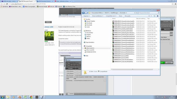

    Sorry my dumbness, but I can't figure out how to install DAZ files, the DIM interface seems the same as it was to me.
    1103 x 903 - 99K
    1739 x 534 - 110K
