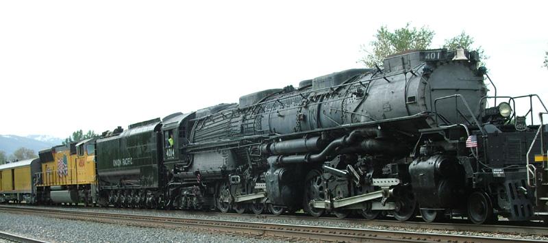

    Since you mentioned working with Trainz, I figured you'd appreciate this article.  It's a recent article about UP's 4-8-8-4 restoration.  Their goal is to get the Big Boy running again by 2019.
    http://cowcatchermagazine.com/union-pacific-big-boy-no-4014-restoration-coming-along-one-bolt-at-a-time-on-pace-for-2019-debut/
    Here's a pic of #4014 as she was being relocated from Pomona to Cheyenne a couple of years back.
    I look forward to seeing her function under her own power again!
    I'd love to see a Daz Studio version of the Big Boy...
