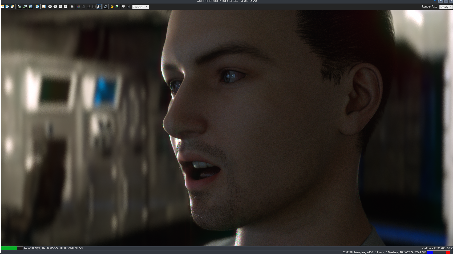

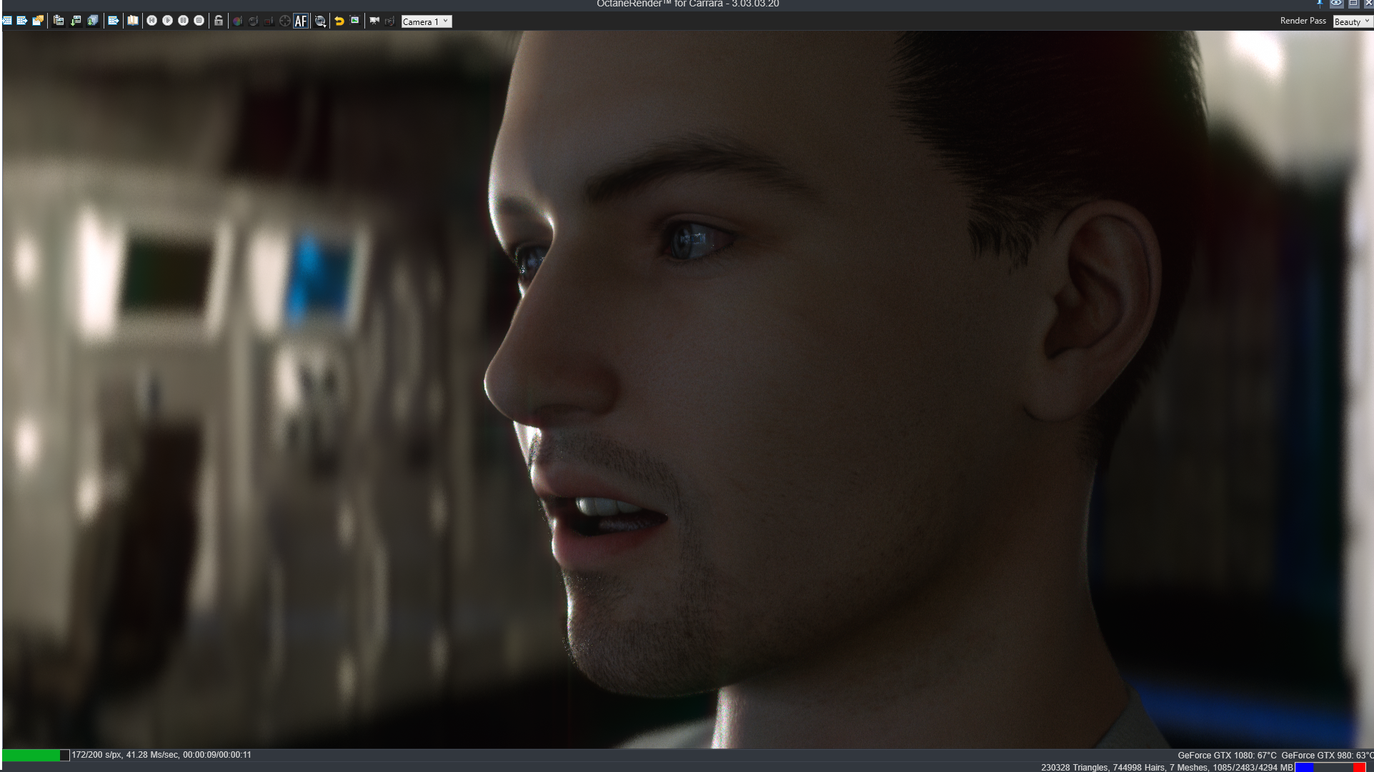

    I did some screen captures to highlight actual numbers. These are direct lighting renders. To cut down on render times I rendered an exr (HDRI) image for the background using the spherical camera in the final render camera position. As such an A/B test between direct lighting and PMC (or Pathtracing) showed very little difference. Not enough to matter for animation.
    So the actual elements in the scene are the M4 figure and dynamic hair and two bulbs; one on each side of the figure.
    UnifiedBrain, while these are not done with either a Titan X or a 1080TI it should be failry easy to interpolate how those cards will performe based on the sceen captures and renders specs below.
    The GTX 980 with a 200 s/px stop @ 16.58 Ms/sec took 29 seconds to render one frame at 1920 by 1080
    The GTX 1080 with a 200 s/px stop @ 24.04 Ms/sec took 18 seconds to render one frame at 1920 by 1080
    Both cards with a 200 s/px stop @ 41.28 Ms/sec took 11 seconds to render one frame at 1920 by 1080
