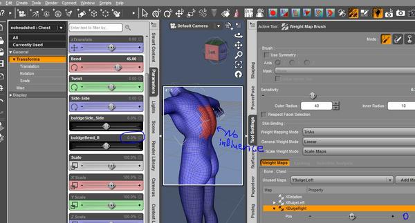

let see my pic 1 (I made shell suit which transfer genesis weight to understand buldge before)
I set ERC for X buldge map of chest, so I can change X buldge map pos and neg value by parameter tab.
"buldge bend R"
100%,, Xbuldge pos value to 30
-100% Xbuldge pos value to -30
zero means no influence ( Xbuldge pos value zero )
you can see red coloerd area for chest node X buldge map (it works when you x rotate= bend ,chest )
then I bend 45 positive chest (rotation chest node 45 degree X pos value)
so that,, if there is buldge map for X rotation,,
and budge pos value are not zero and plus value, the coloerd vertices move to the normal vector
eg,,, now pos value is +30 that means when you bend positive (+ 45)
the colored vertices move to normal vector with 30 strongness.
keep the bend 45 positive rotation for chest,
if I change the pos value to 15,(I changed buldge bend R 50%) the movements reduce (move half) pic 2
if I change the pos value to 0 , the buldge map can not make infulence pic 3

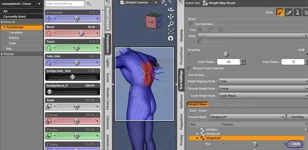

now I change the pos value to -30 , you can see the vertices move to oposite normal. pic4
so that,, pos and neg means which direction,, you rotate each node . (positive and negative)
then pos value means the strongness of the buldge map influence which move to coloered area to normal vector.
you can see,, the pos buldge map can only work when you bend positive direction.
when you bend negative value,, the neg buldge map can only work .
