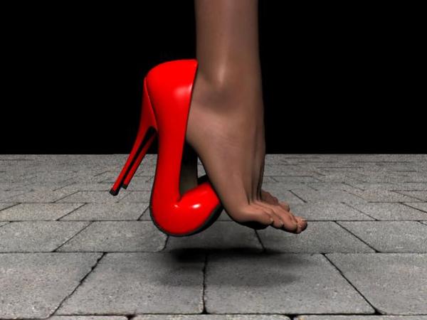

    What specifically is the problem you're having? Is it the one shown in this image?
    If so, what I do is this:
    Once you have the pose applied that comes with the shoe to get the feet posed correctly, go to each shoe and zero out the X rotation for the shoe Toe bone (or was it the Foot bone...I think it was the Toe bone). That seems to snap the shoe into place. Just make sure you're doing the SHOE's toe bone, not the character's....
    You may also have to rotate the shoe's Foot bone into place.
    Another thing I do on occasion (as necessary) is to make the character's toe invisible so there's no poke-thru. And of course you want to apply the "foot for shoe" pose that comes with V4 or whatever.

  • DustRiderDustRider Posts: 2,921
    Thanks!! That is exactly the problem I'm having. The key must be rotating the toe bone first, I was rotating the foot bone first, then rotating the toe bone, and things just always seemed to not work quite right - I'd get close but not quite there.
  • JoeMamma2000JoeMamma2000 Posts: 2,615
    dustrider said:
    The key must be rotating the toe bone first...
    Yeah, I think it is...
    What I do is just go to the X rotation value, which tends to start out as 60 or -60 degrees or something like that, and just erase that and put in 0.0
