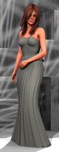

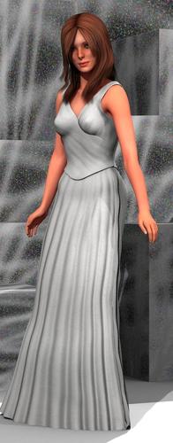

    Not sure I really understand what you're asking. I'm going to ponder it a bit. I own GenX but other than playing with it I really haven't gotten much use out of it. A shame I know.
    Anyway, here's the Sojourn V4 dress converted to Genesis and then Genesis morphed to G4 proportions. I wanted something extremeish to see how it would hold up. It did quite well (booties were only auto-converted, but I may try your methodology with similar boots designed for Genesis to see if I can get a better result when I can find some time).

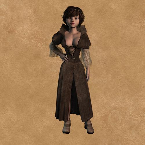

    I never rigged anything for genesis or gf2 so I'd like to ask if the frontpage tutorial would work in general for a new item, not any old one to be converted. Here's the dress picture I've modeled for Girl 6 morph. I want to rig it and check if it would work backward with base gf2 through some options of rigging tools. Some time ago I red several tutorials in the forum posts but unfortunately I lost all saved posts links. The new search gave no positive result. I'd appreciate very much if someone pointed me a good tutorial on rigging clothing for genesis or confirmed the title tutorial working for general rigging purposes.
    360 x 720 - 52K

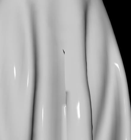

    Doesnm't work. There are holes in the front middle of the dress between the space of Genesis's legs, at least with Arah's Autumn Spirit and Galadriel.
    I have found that when there are holes/missing polygons/what have you, that neither collision nor smoothing affects these AT ALL.
    So how do I fix this? How do I prevent this? It's an awful lot of work for nothing and you've completely gotten my hopes up only to dash them. Do I have to post a screenshot?

    a screenshot would be helpful. Also, the geometries might be a problem. A lot of Victoria 4 stuff just doesn't work very well when subdivided because the modelers didn't understand SubDiv at the time, or didn't care. So if it's subdivided, that might be it. If it's not, there's something else going on.
  • IceEmpressIceEmpress Posts: 639
    How do I tell if it's subdivided?
  • Richard HaseltineRichard Haseltine Posts: 112,021
    Is there a Mesh Resolution group in the Parameters pane with the item selected?
    edited March 2014
    Mesh resolution "group?" What is that?
    I know that Arah's models are made up of a conglomeration of several objs (like, two or four for sleeves, one for a ribbon, one for the torso, etc.)
    Is that subdivision?
    This is not the case for Galadriel, though.
    I'll get to a screenshot a little later.
    Post edited by IceEmpress on
    Here's an example. In the Autumn Spirit dress.
    This does not occur when I use the SRMS on it or Galadriel, though it is sometimes a problem on pants (looks like Genesis bent over and ripped them)
