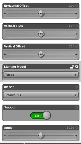

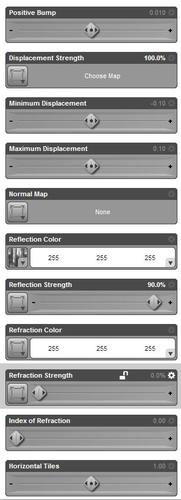

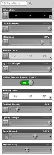

I don't have this shader pack, I'm sorry to say, but if you could post a screenshot of what the shader looks like in the surfaces pane when you have the a surface selected, it might help. Somebody may well come up with the asnwer anyay, if you just hang on a while.
Hi, I hope this is, what you meant:
