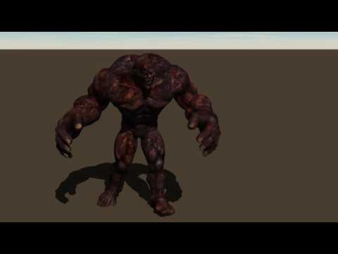

Motion Capture in Carrara
I used ipisoft motion capture to do this.

    I used 4 ps3 eye cameras, they were only $7 each on amazon.

    It really is quite easy. I couldn't get ipi to work directly with Carrara though.
    So once you've created your animation in ipisoft follow the insructions on their website to import it into Daz Studio. Then just create an aniblock from studio keyframes, save the aniblock to disc. Then open Carrara and import the aniblock with the aniblock importer. This works great for Genesis and Genesis 2 and I assume it'll work fine with M4 and V4 but haven't tried them. The only problem I ran into was with an original figure like Mestophales' Brute X. I originally intended this animation for Brute X. The animation imported into studio just fine, but I tried several different ways to transfer the animation over to Carrara with no luck. So I switched to the Infernal Behemoth and it works just fine with him.  (maybe even better because of his oversize arms)
    Also the animation was not edited in either studio or Carrara. That's how it looks straight out of ipisoft. I would recommend it to anyone that's interested, I'll be diving in more myself. This is for a music video for a friend, Xoe Fitzgerald the time traveling transvestite.
  • ScarecrowScarecrow Posts: 192
    The most important thing I found for getting good results is having a large enough space that is also somewhat light colored, I hung some cheap paper painting drop cloths to cover some glass and darker colored areas. Adequate lighting is pretty important too. I also got better results on the arms when I wore a long sleeve shirt with a T shirt over it, so your arms are a different color than your torso. That how ipi tracks your motion, by the color difference between you and the background. So light colored background and wear dark colored clothing, they recommend green, blue or black.
