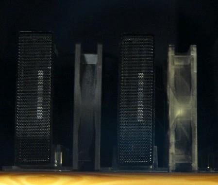

    I use these:
    http://www.ebay.com/itm/SS481-SANDBERG-USB-3-0-Hard-Disk-Box-fuer-3-5zoll-8-9cm-SATA-Festplatte-Bis-5-G-/162411636175?hash=item25d07ce5cf:g:8~MAAOSwXYtYtApn
    They boot automatically with Windows. 5 years factory warranty where I buy them, don't know about warranty at eBay. They have metal housing, no fan but with a cooling grid on the front. I have 3 & 6 TB WD Red drives in them, they stay fairly cool when idle, it's 27-30° C here most of the time but they don't go over 45°. When doing long backups I cool them with Antec 120 mm 3 speed fans, medium fan speed is enough to keep them at ~40°. Fans stand fine on the edge even at max speed.
