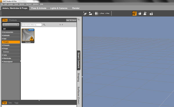

Nightmare! Upgraded from 4.0 to 4.5 and I can't see any of my content!
SertorialSertorial Posts: 962
edited February 2013 in New Users
Everything is now a mess! No smart content is visible. Non-smart content is in the wrong category!
This is really alarming! Why on earth has DAZ 4.5 changed where it thinks stuff is?!
How can I get back to DAZ 4.0. Is there still and installation .exe somewhere?
Why oh why did I upgrade!
1273 x 784 - 144K
Post edited by Sertorial on

    Because, in 4.0 it was in the wrong place...
    Did you update the Genesis Starter Essentials, too?
    Post edited by mjc1016 on

    It was in the wrong place, in as much, as the way it was set up in 4.0 wasn't the way it needed to be to get both the DSON importer for Poser and the DIM to work correctly...
    Updating the starter essentials will go a long way to fixing, if not everything a lot of it....as SC is context sensitive, if there is no Genesis, there is nothing to be shown...]
    Is the CMS service running?

    I’m not sure what the “DSON importer for Poser” is, could you maybe explain?
    The DSON importer is made for Poser 9 and Poser Pro 2012, and is used to import Genesis and it's accessories into Poser. Prior to this, Genesis did not work in Poser at all.
    Really? You think installing Genesis will fix the non smart content too?
    You need the Genesis Starter Essentials to have Genesis at all. When you select Genesis in Smart Content, all of the itmes that Genesis can use are displayed, it is context sensitive. Genesis Base was updated from DSF to DUF in version 4.5, so you should install the correct version of Genesis Starter Essentials for the version of DS4.5 you downloaded.
    I’m not sure what the CMS service is…. How would I know if it’s running or not? Could you enlighten me?
    CMS (Content Management Service) is a process that runs in Processes and Services, and it is required to populate the Smart Content pane, among other things. You should have been asked to install it along with DS4.5, but when upgrading to 4.5 from version 4, it would have been a good idea to uninstall the CMS first, then let DS4.5 install the new version.
    On Windows, you will see it running in Task Manager, and to start or stop it, go to Start > All Programs > DAZ 3D and look for the CMS entries.

    Your Problems are two fold, your Catagories were not kept when you Updated to DS4.5 and Second Most none Genesis content only shows in the Content Libary Tab and Not in Smart Content. Look for all your Older content here
    Content Library>Daz Studio Formats=Mat files and Poses ect for DS
    Content Library>Poser Formats=Figures, props and all the Poser format content.
    Until DS4.0 and Genesis No content was Smart. Only older content that has been updated will show in Smart Content. And that is not very much so far. I hope this helps.
