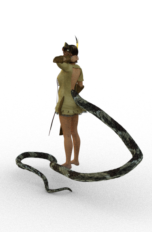

    OK, I loaded up the Snake Tail that is part of the Succubus pack.  It IS possible to separate it from the legs (unparent it, and fit to none).  From there, you can start adjusting the scaling.  Start opening up joints until you hit Tail 1 (there are 31 tail sections, not counting the abdomen and pelvis. Wow that's a lot of sections!).  You can extend each tail section/subdivision using the y axis, but you probably will not want to do much more than 200-300% as this stretches the texture.  Continue working down the tail, stretching each section.  You may also want to thicken the tail, or make it slimmer, using x and z scalars.  I did initially scale the tail down at bit (at the Snake Tail header/division) so that it wasn't so massive at the base.
    Weird things happened when I tried to scale at the hip (tail twisted and deformed), but by starting at tail section 1, and maybe the pelvis and abdomen, things seemed to work ok.  Trial and error.
    Here's a quick render showing how mugh length I squeezed out of the tail after scaling it down initially (so that it wasn't overly massive at the tailbone of Serena there).
    This was a quick and dirty illustration of how you could do this, not looking to win any beauty/posing contests here.  You'd probably want to carefully position the base of the tail as well, again I'm just illustrating how you can stretch it after scaling it down from full waist/hip size.
    After all of this, I attached it to the lower abdomen (drag the tail to the lower abdomen subdivision to do this), so that the tail base will move/bend/twist with the figure.  The pelvis is another choice, depending on how high/low you want it to attach/bend with the figure.
    525 x 800 - 306K
