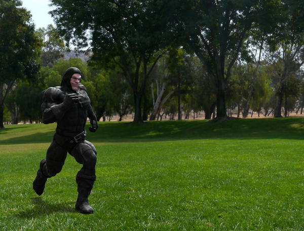

    I suspect the sky dome image isn't high enough in resolution. If you view the image in Runtime\Textures\Dreamlight\Light-n-Go\TempleRuins the mountains in the sky dome image is only about 250 pixels high even though the pixel dimensions of the image is 6000 x 3000.
    Dimension Theory's "Urban Recreation" HDR light set, which uses a sky dome like the Light-n-Go sky dome, has extremely high resolution sky dome images that are a whopping 16384 x 8192 size, which results in very clear renders. Here is a sample of one. The trees in the background are 1542 pixels high in the sky dome image.
    Dimension Theory had plans to go on road trips to take images for future add-on packs. I hope some landscape packs get released eventually.
